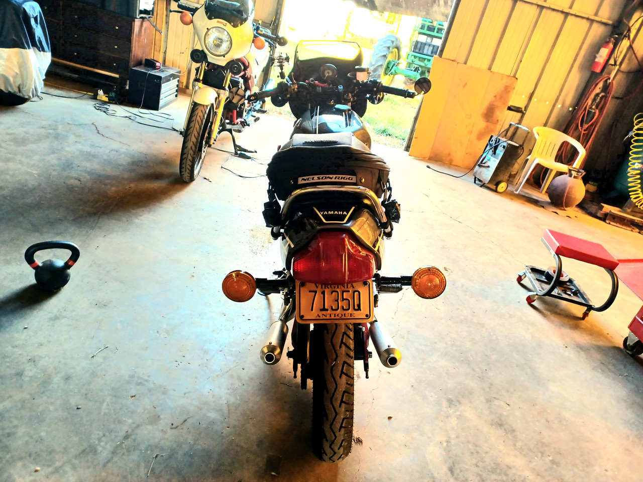

Rode 30 miles on the Gray Ghost in the Blue Ridge Mountains. 600 miles and change since the build. Replaced the quite wide H1 500 Kawasaki rear turn signals with a pair from my RD350B parts stash. I masked off the lenses, then bead blasted them and shot some Rustolem semi-gloss black. New 1156 LED bulbs were installed. They aren't perfect being 50 years old but they work great and free is in my budget.
