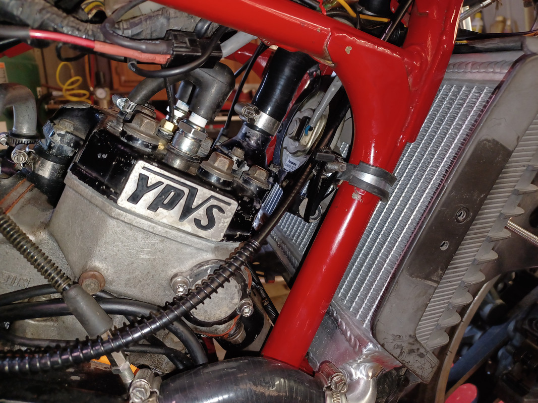

And I hope your alu radiator fits. I purchased 2 (kind of when they first came out) and had to cut off and relocate the big pin on the top. On both of them. Maybe they have gotten better.
I hope so too Ken. I noticed the pin location is different on the two yesterday when I was holding up the new one next to the factory radiator. On the factory radiator the pin appears to be centered. On the new one the pin is positioned to the back like the ones in your picture. I have to finish up the trailer fenders and service the GMC pickup before I can get back to it. Worse case if it doesn't fit I will take Evans Ward up on his kind offer of the use of his spare and change it at the Gap. I got a new RD400 petcock from Economy Cycle yesterday so that should solve that issue.

What I thought would be an hour job turned into 3. I had to bend the top locating pin, grind the frame, massage the right lower mount with my ball-peen as it was strking the bottom tank and bend the top two pipes to get it to fit without striking the frame and get the clearance needed to install the top hose. I had the radiator on and off about 58 times. I ran it up afterwards and no leaks were noted. Despite the fitment issues it appears to be a good product. $ 91 shipped Amazon. The radiator guard fit at the top but due to it being 40% more capacity the bottom tabs were about 1/4 inch from sliding into the grommets so a couple of cable ties took care of that. Then I changed the petcock and the new one from John at Economy Cycle works like a champ. I left the lines off over night suspended  over my cup to make sure But no seeps after 6 hours. Then I drilled out a loose rivet on the RH chamber and installed a new one. No more floppy can. Tomorrow I  will test ride it and load it on the trailer.

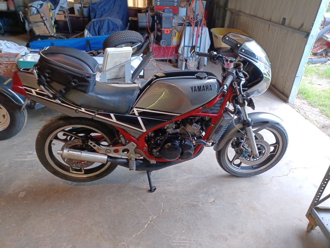

Test ride was most excellent. Installed NOS Nelson Rigg tailbag and it is ready to load. Thank you to everyone who helped me bring this one back and to my friend Karl Jones for giving it to me.
Looks great Tim! :olaf: Congrats.
Now go have some fun on it  :vroom:
