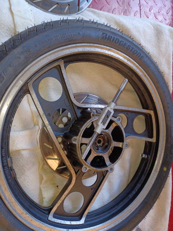

Today was rotor day.
Turns out the rotors Yambits sells for the RZ are drilled Ferodos.
The left side came off pretty easy with a couple of good licks with my BFH and impact driver. I had to break out the heat gun for the ones on the right.
Nice new bolts pre-treated with blue loctite and torqued to the recommended 14 foot pounds after all the holes were chased and the mounting surface was scrubbed with a wire brush. Took the y-boot off and put pods on to see if it helps the very loud 5K howl. Test ride tomorrow.
