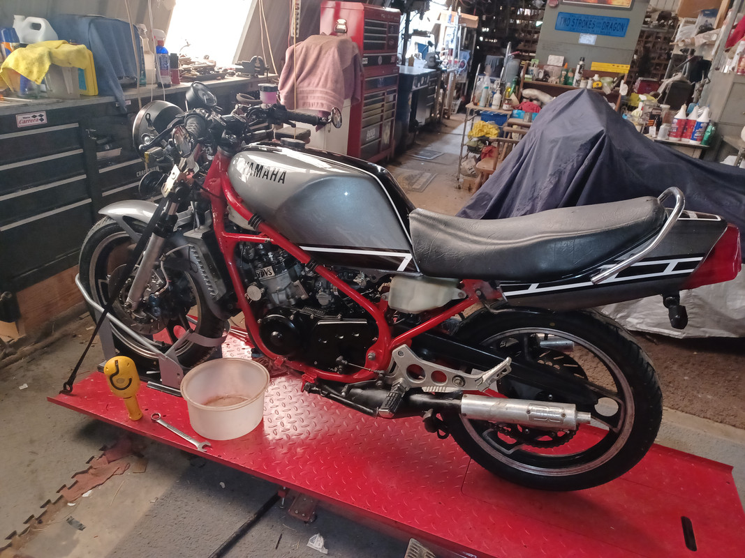

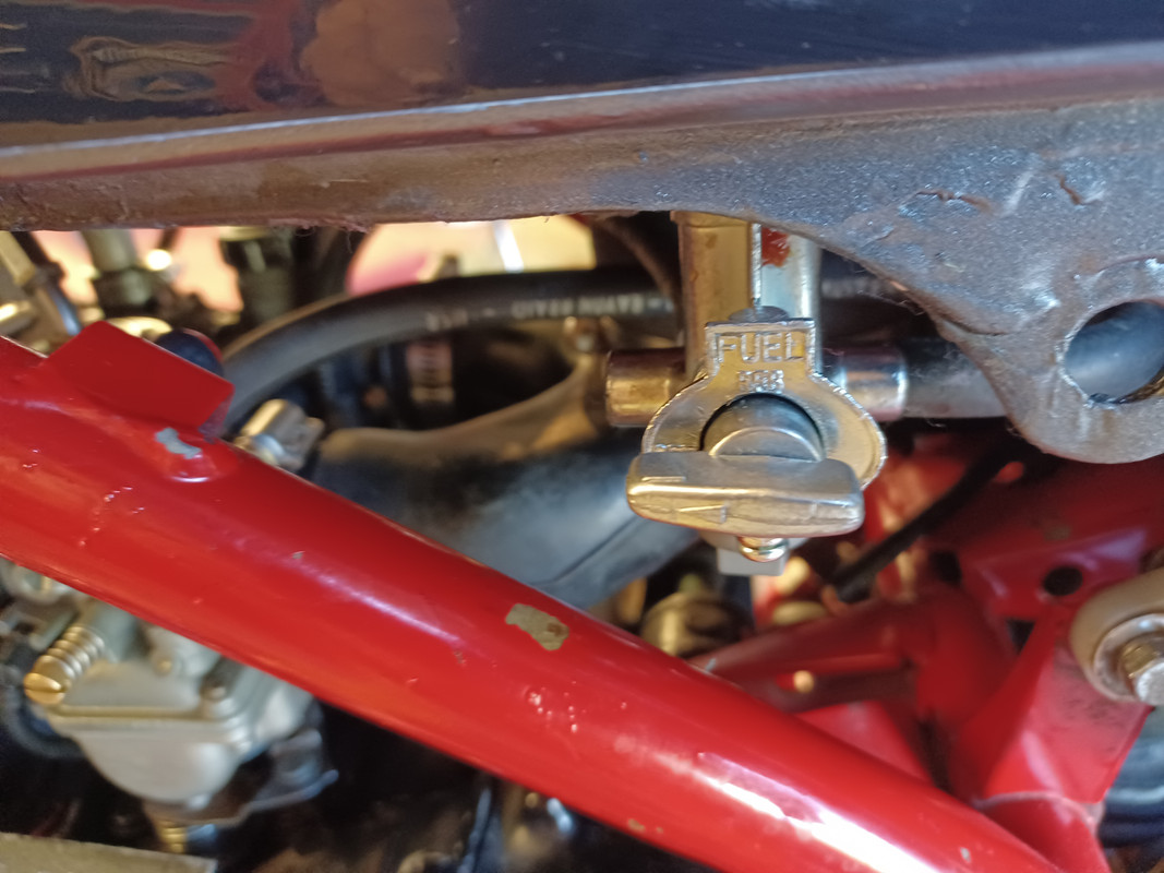

RD400 petcock installed. If time permits I will do the mod to use the factory knob like I did on the white bike. It is useable as is. Put in 3 gallons of 90 non ethanol and a set of 280 main jets and ran it up. Had a seep at the temp sensor and a 1/4 turn tighter fixed that.

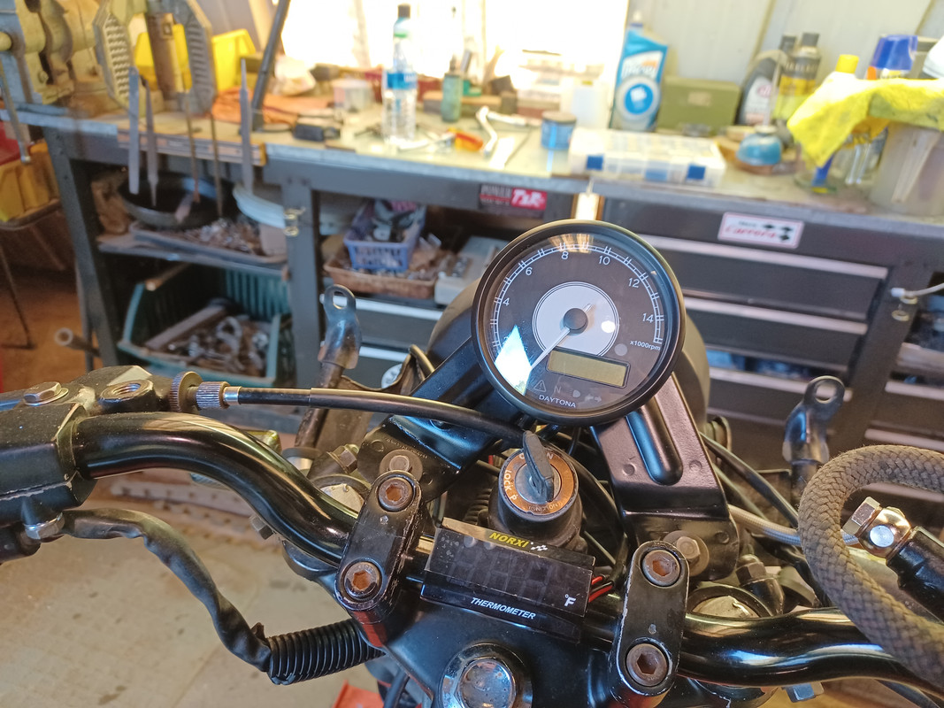

Daytona Velona speed sensor installed. The literature says it turns the mechanical signal into an electronic signal the instrument cluster can read.

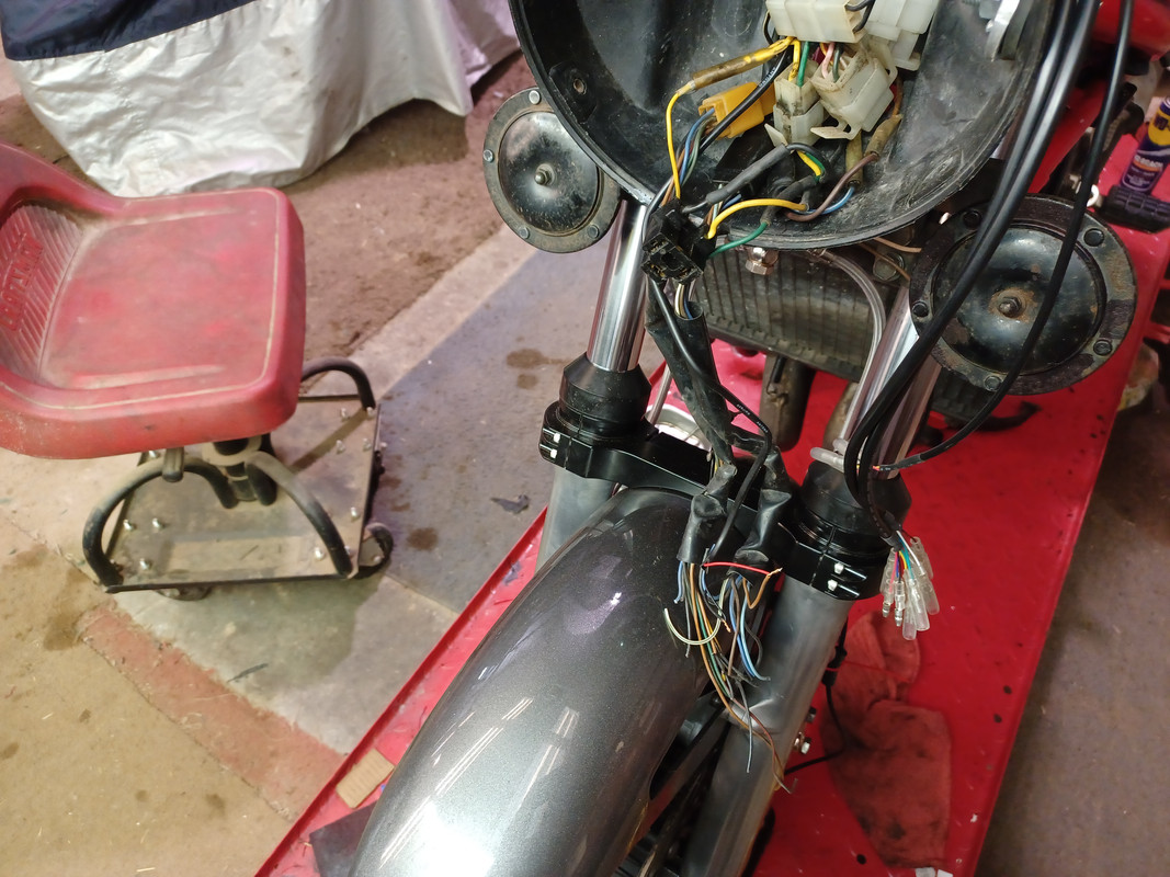

Wiring cut off of original Canadian cluster and plugged back into the harness. Frank B is coming over to wire it up for me tomorrow. :taz:

Frank B came over this morning and we got after it. Frank performed his wiring magic and I love the Daytona. Thanks again Frank! He also rebuilt my floppy kickstart with a home made shim under the spring and ball.  :patriot: :patriot:
I hope to road test it tomorrow at some point. It is too rich on the pilot as it doesn't want to start with the enrichener selected on but fires right up with it off. Had a persistent seep at the temp sensor so I pulled it back out and replaced the Teflon tape and ran it again. No leaks noted. I will also need to calibrate the speedometer portion of the Daytona. A very good shop day!
