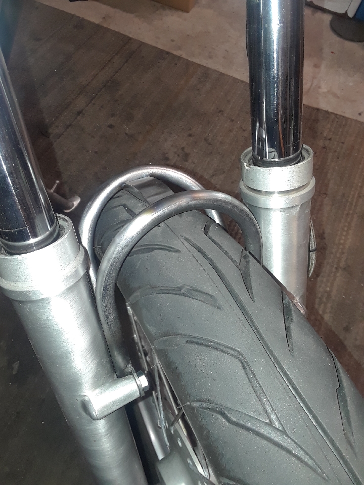

made mine on a tubing bender
2 small flat plates on side, added a tapped plate at top to support fender:
my friend david wheeled me a fender out of titanium sheet and done
TI bolts and abs spacers:

nice. yup that type is where i got the idea.  :metal:
Im mixed about fork braces that clamp on. i have a few bikes with them, but i also have had some that distorted the fork leg -just enough- to cause a fork seal leak.

Try to replicate that.  Not quite as stiff as those ugly tubular designs but quite adequate.
no, its steel, structural 3/8" tube tig welded onto the plates, not conduit.
and IMHO, not ugly at all.  :whatever:

i did set mine back quite a bit, you really cant see it unless you look for it. i agree a lot of them are just way too huge.
it son on this pic, just not hanging way out there. the longer the rod the more it will flex. i made it as short as possible. it absolutely made a big difference.
