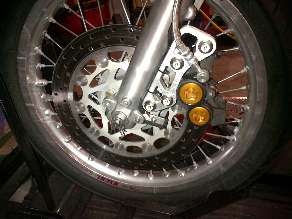

I recently set all of this up on My 73 Rad350, and wanted to share some pieces. I used the FZR rotor, and designed the spacer on sendcutsend. The spacer was 105mm OD, could have been a cluple mil smaller to match up with the hub, but still looks very good, and was abit too snug with 64mm ID. 65 would have probably been better. The bolt holes were 8.5mm, 80.5mm across, center to center.
The 8mm rotor bolts were perfect at 35mm. with a 1/2in caliper bracket, the fork to bracket bolts were 40mm, bracket to caliper bolts were 30mm.
My only issue is this bracket may need some tweaking. It has the caliper hanging the pads about 1/3 off the rotor, and concentrates all the heat on the top half of the rotor.
As far as this caliper being heavy, it is still way lighter than the factory unit, even with the bracket bolted on it.
My complaint about the factory setup was that even with a stainless line, it would bite hard when you first started braking it would bite hard, but it won't give me anymore past that. This new caliper will actually brake harder when I squeeze harder.
