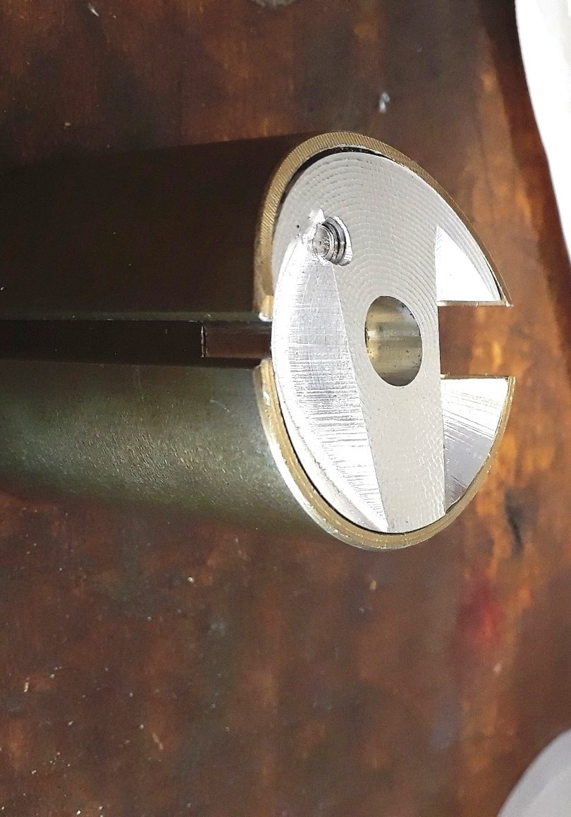

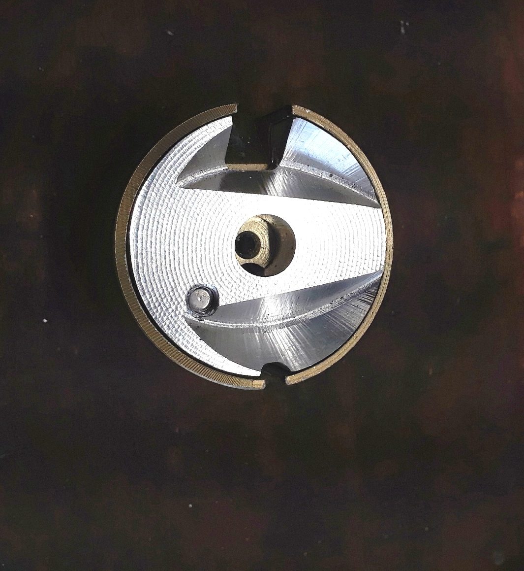

I use UfOs often , I install many for my customers . They work great and cause a round slide carb to out flow a flat slide up to 13/16 throttle opening . I modify lots ofcarb with venturi dividers , both mods together are wonderful . They require a smaller pilot because the signal to the needle jet is increased and starts pulling much sooner causing a greater over lap during transition of circuits  also cuttint he slide arch is necessary usually 1 to 2 mm . The are worth the effort . Check out my web site richstaylordporting.com aor give me a call if you would like to know more

More pics that wouldnt load
racerclam
again
racerclam
one more

The blades look like they could help but what tells you where or how many and how long does what?
racerclam
How many? Well I started with doing just 2 at half throttle position , the difference was evident ao I went to 2  Two at half throttle ann two at 1/4 . Worked even better noticable better snap and pull through those windows , Then about 10 years ago I tried 6  dividers 1/4 1/2 and 3/4 Waaaay better linear power through out . So I would say that experience told me what worked . How Long you ask they reach to the slide and conform to it with about 1mm clearence . I have alot of them out there . Go to my testimonial page of my web site and read what one guy said how it worked on his 2016 TM 125 with power valve . I told him thai I believed that with m carb a power valve wouldnt be necessaayso he did his own experiment , Check it out . I first did porting and carb as well as my reed conversion on His vintage racers on his 370 Bultaco as wel as hus Rickman Hodaka , both on the same page . I have don 15 carbs for a vintage snowmobile racer plus several port jobs and he won the biggest ice flat track race in the country with his Kohler 440 tripple that made 126 hp and 98 lbs torque . The is also a RD 400 on my site that had earned the #1 plate on east coast using my carbs and porting .

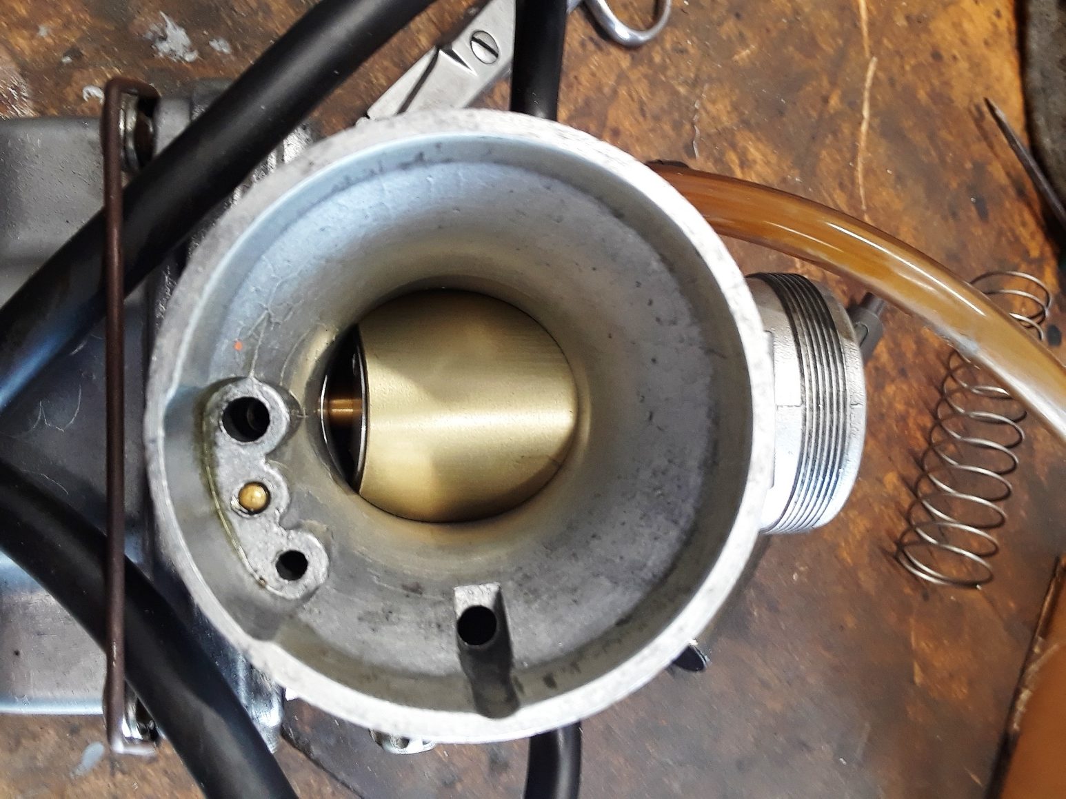

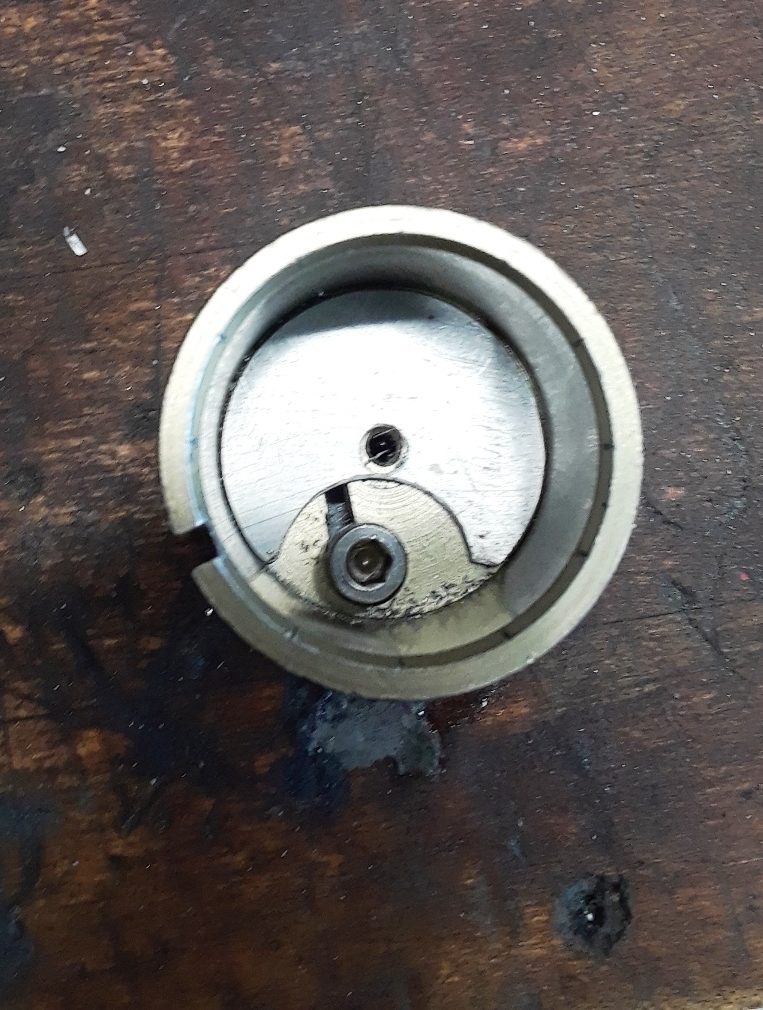

I havent had time to play witht hem at all, but i did dig out the carbs and the inserts and mocked 1 up. this is what they look like. to me, way better built but cant speak to fuction.
I need to correct my drawing as the 'bolt' hole for the slide was a hair off (on me) and resubmit to bob for the 34's, but i can make these work.
