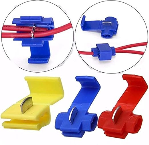

The herpes of the electrical world. Poor connection, damaged insulation, and cut strands (resulting in reduced current to your loads). Bad enough when first produced by Scotch, but now cheap copies make them very bad. Vetter sent them with their GoldWing fairings, and the GL1000s that I've rescued have each had a headlight bucket full. Removing them I usually find about half of the copper severed. If just to a signal I might just heal the insulation wound with liquid electrical tape. Otherwise it requires the soldering iron to come out for a proper splice.

Quote from: quocle603 on August 28, 2020, 06:13:37 AM
If I end up stranded somewhere because of this, I will let y'all know about my struggles :whistle:
Take it from me, I *did* get stranded by a Scotch connector.  It's so easy to avoid.
Move to bullet or solder connection......
Thought I was the only one.
bit me once before as well.  I keep a few in the toolbags as an emergency fix but otherwise, nope.

I was planning on using solder for this connection but after reading this thread is seems like a scotch connector would be a better choice.  :dawg:
