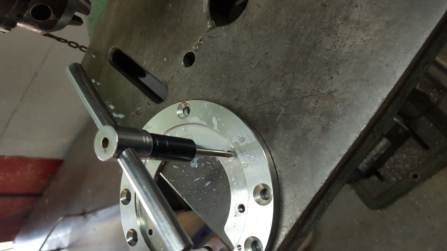

I always found the wires were pinched behind the stator plate on the cases, so I alway grind the cases a little to not pinch the wires.
In this 2nd pic, I also grind a little off the top corner raised part right by the upper bolt hole and wire loom hole is so the pickup plate will clear.
I have also found some engines castings are all different so I grind the back of the stator plate most of the time just to be sure the stator plate fits perfectly flat without rocking around the seal casting area.
