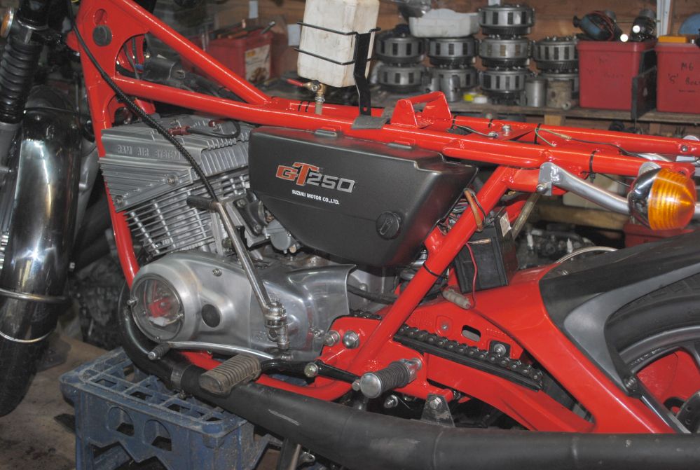

wade, there is a reason for the 46 tooth rear sprocket. when i was messing about with the rear spring height, the dogbones angles and all the rest of it, i had a problem with the chain dragging across the top front of the swingarm - a lot. so i swapped the 41 tooth sprocket for a 46 tooth, to lift the chain up and away from the top of the swingarm - which it did. i then made some 25mm longer dogbones [or bananas as i call them, cus that's what they're shaped like], and fitted them, which lifted the chain even higher. then of course i realised that the rear shock was bottomed out, or is it topped out? as it had no weight on it. if it was compressed then the chain would lift anyway. so where i am atm is 46 tooth rear sprocket, long bananas and the chain not dragging. where i want to be is fitting the rear tyre, weight on the monoshock and see how far off the swingarm the chain is. THEN i'm going to try the 41 tooth sprocket, which will put me on gt250 gearing, and if the chain is still clearing easily i've got a 39 tooth to fit. btw, i had to mill a 3mm deep circle out of the back of the sprocket where it bolts to the wheel, as it stuck too far out to get the chain run right. still loads to do before i'm happy with it  8)

been there. the lightweight chain drags pushing it around, but with me on bike its way off. it can be frustrating but f-it. had same issue with grom and LT250 motor,, but again, with arider on no issues.  Looks great.  :cheerleader:

thanks mark, that gives me some hope all will turn out right eventually. the original yzf125 was a smaller chain and sprocket size, so i got a [i think] something daft like a 410 suzuki front sprocket [520 chain instead of gt250 525] with 15 teeth. the rear sprocket is actually off a rg250, as it was the only one that was a 520 chain and the 8mm mounting holes were 100mm apart. BUT, there were only 4 holes. so, 2 of them were right and i drilled very carefully another 4. hey, if it was easy everybody could do it and then it would be boring. oh yes, the original 520 chain i bought dragged on the frame. that was a hd chain, so i bought a standard type and that was fine. people make me laugh when they say how easy just to do something. they don't know the half of it. at the end of the day, it's great fun and i'm enjoying it. i'd enjoy it even more in a warm workshop instead of a cold, draughty shed, but suppose i can't have everything  8)
cheers, gil.
p.s. all the cross tubes i added make a triangle and unless they actually collapse in the middle there is no way they can push up, which is where the rear shock would be pushing them. all around that area is engineered like the eiffel tower and if it cracks or splits because there are no gusset plates i'll report it with one of these:  :bang:

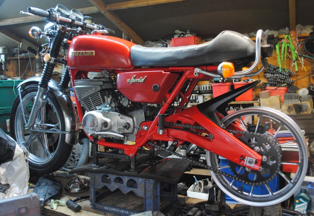

pinched a good fuel tank and sidepanels off one of my half built projects and fitted them just to see what it would look like. a tad too much red methinks  8)

lines look great. id go silver with black pinstriping. dump the special badge. remides me of king/queen seat GS's
Gil Gallad
silver with black pinstriping? hmm, sort of like the old nortons et al? tbh i always preferred the black with gold pinstriping. whatever, the fuel tank and sidepanels are not staying red  8)

p.s. i thought you'd like the 'special' badge mark, as it's actually off a yamaha  :cheesy:
