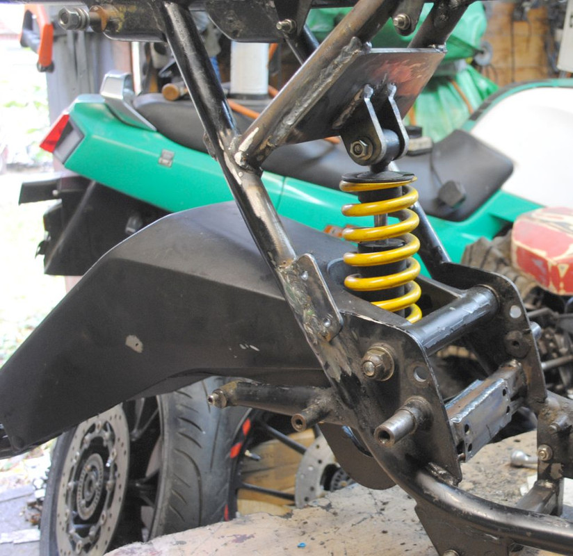

ok, i got the reed valve gt250 engine running fine. anyway, to the point where it will start first kick every time. now what, thinks me? i saw this monoshock swingarm off a yam yzf125r and liked the looks of it. first fit i'm very pleased with, but there's a lot of fabbing between now and the finished product. why do i keep doing this to myself?  ;D
cheers, gil.
first fit:

rear shock mount:
im not sure if you are going to, but id add a gusset per side.
:twocents:
Gil Gallad
hi mark, sorry i thought i'd answered this. obviously not  :eek: across the back of the plate is another square crossmember, welded right above the shock mount. it's welded right across the plate, top and bottom, as well as welded to the diagonal frame tubes. plus the diagonal tubes sit under the top frame tubes, so they won't go anywhere. tbh, i think it's well over engineered, and anyway, it's now at the powdercoaters having a nice bright red put on it, so too late  8)
cheers, gil.
ha. sweet! should be fine, im known for way over engineering stuff. love it.

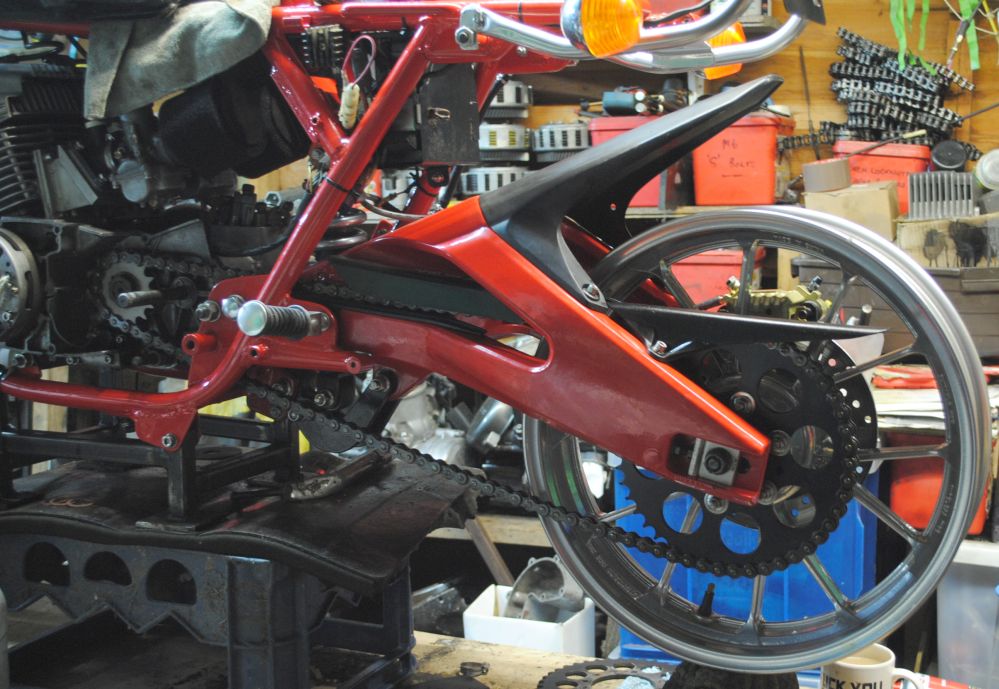

getting there. sorry i haven't got the time to commentate on everything i've done to the old girl, but as you can see, i've been busy. working on the rear brake atm, after spending several days getting the chain run right. excuse the mess. when this is finished i'll have a tidy up - promise  8)
cheers, gil.
reed valve gt250:
with rear wheel:
50gary
Quick note, gussets are usually placed on the 'side' of the tubes, so as not to cause a stress riser, two cents.

That rear sprocket (sorry, chainwheel) looks big, Gil; are you going to trail ride that bad boy?
