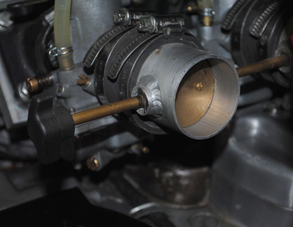

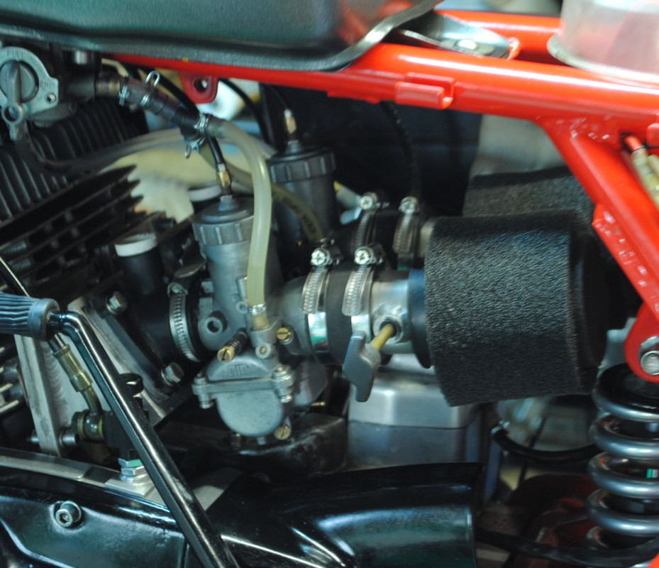

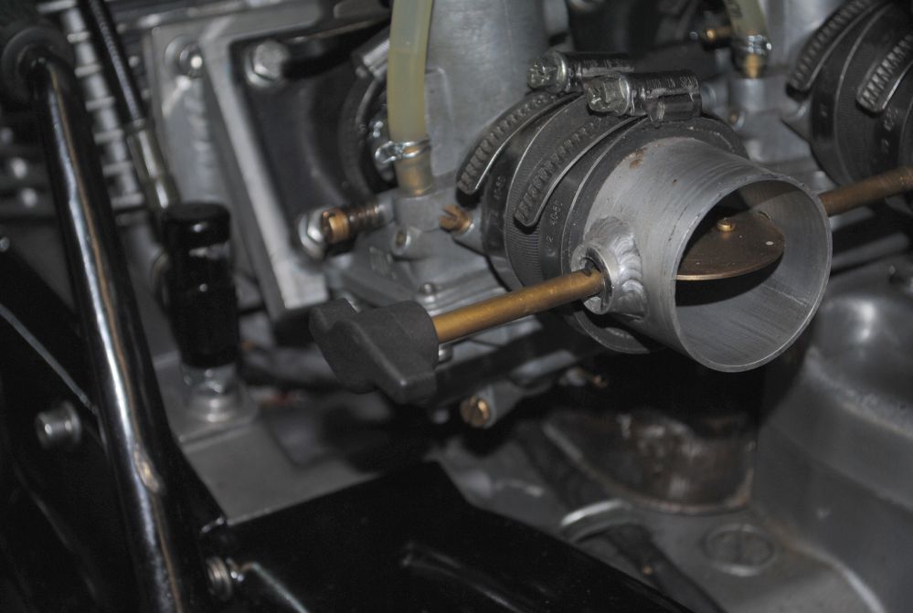

after getting sick and tired of will she/won't she start, dependent on the weather, the government of the congo or the price of eider duck eggs, i decided i'd had enough. a few years ago i had the same problem with a newly rebuilt rg250 powervalve engine, which turned out to be the chokes not working properly in the flatslide carbs. so i decided to build myself a pair of butterfly type chokes. after i fitted them the rg engine fired and ran first kick every time. got bored with it, took the engine out of the modified gt250 frame and stashed it for another day. butterfly chokes doing nothing, so why not fit them to the gt250 reed engine? what did i have to lose? scratted round for some clips - trust me, new mikalor clips the right size on order - and put some old wide jubilee clips on. normal choke off, butterflies closed and she fires and runs first kick every time. couple of photo's of the butterfly chokes fitted and the inside of one of them. just need a good clean, new mikalor clips fitting and bob's your uncle.
cheers, gil.
butterfly chokes:
choke closed:
choke open:
I can see how running with a non-stock airbox would almost require such a setup to give sufficient restriction for starting. A good mod for pods users.
That is an interesting solution for sure.  A butterfly choke will reduce airflow by 5-20%, so I hope they are larger than the carb bore.
But the fact that they work and regular enrichment circuits don't is more interesting.  It suggests that the enriching circuits are not doing what they are supposed to do and that suggests a lack of air velocity through the carb.  With that sort of choke, the pressure differential between the intake side of the carb and atmospheric will be substantial and consequently fuel will be dragged through every jet.
Makes me wonder if it needs softer reed petals that open further at very low engine speed.  In theory, two stage reeds would be perfect as long as the small reeds petals are thinner or are "softer" ie they bend with much less force.  I wonder what they came from and if there are more suitable reeds available.

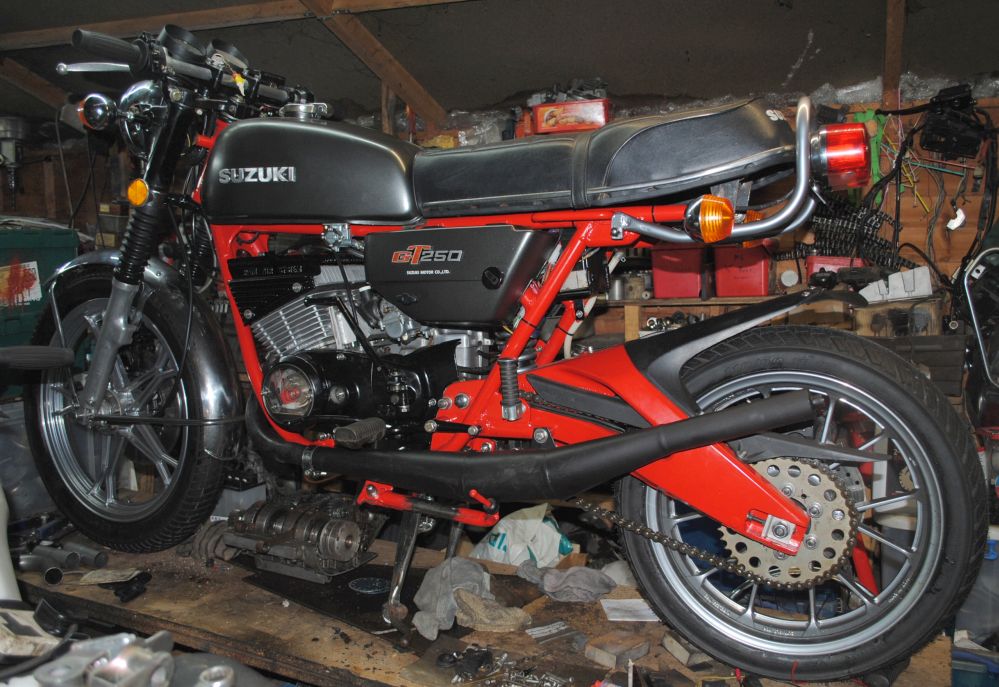

i've got her running well. not as well as i'd like as i think she's still running a bit rich. that could all be sorted after a phone call to ron at fahron who's put me onto a bloke about 20 miles away with a dyno. plus, he only does 2 strokes. so hopefully i'll find out what meagre bhp she's kicking out and he'll sort my jetting out for me as well. i replaced the long bananas on the rear shocker with shorter ones to lift the rear end up, which meant i had to extend both stands. all done now, apart from having the stands powdercoated. anyway, photo is as she sits now - hopefully nearly finished. new project in the pipeline, after buying a 2019 gsx-r125 rear end for a start  :thumbs:
cheers, gil.
reed valve monoshock gt250:
so cool, i like it a lot. curious to see the numbers on this.  :toot:
Hats off to ya Gil, she's a beaut!
