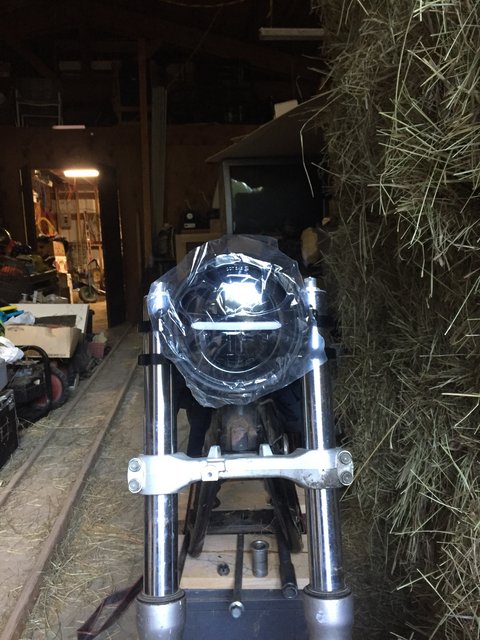

From Speedmotoco in Oregon:

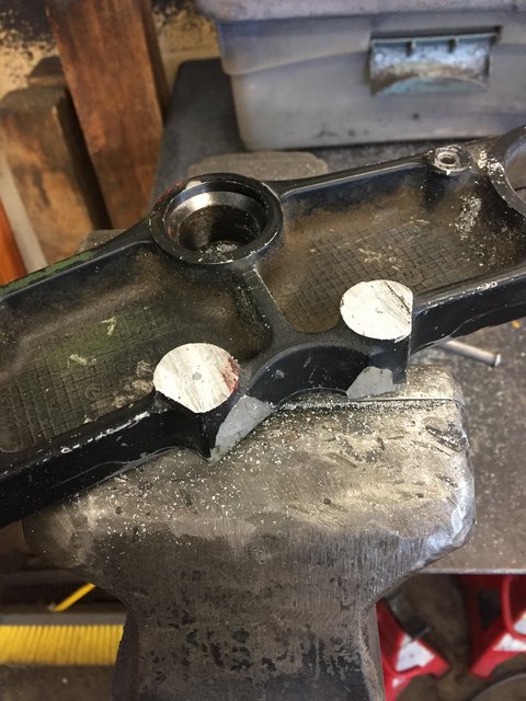

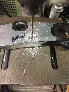

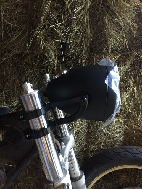

LED headlight with built-in GPS speedometer. I'm pretty happy with it, but the top triple clamp had a ring to surround the ignition switch and posts to mount said switch that were in the way, so out came Mr. Hacksaw...
Also the first step in the handlebar riser scheme. More material to be removed with a die grinder burr, but I need more paraffin wax.

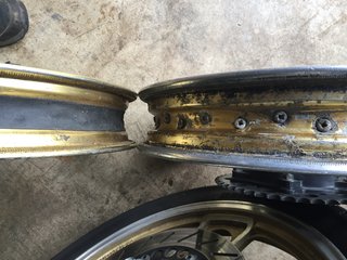

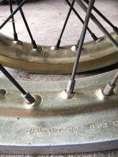

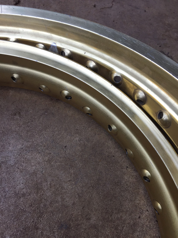

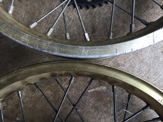

Today I hid from the rain and dismounted the paddle tire from the YZ490 wheel I bought, and brought it together with the TDR250 wheel. Both D.I.D 2.50, 36-hole rims, so they're the same...or so I thought.
The TDR rim is a delicate flower compared to the open-class dirt bike piece. What a brute.
So I'll clean up the YZ rim and address the worst of the scratches before having it anodized again, and hopefully get it pretty close to the same color as the front. Both rear wheels gotta come apart first...

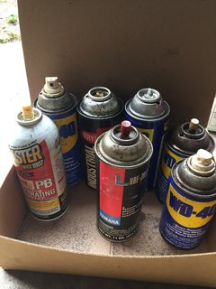

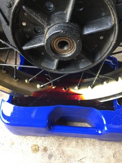

...and to that end, I'd like to not destroy the spokes or nipples in the process. Don't you hate it when the can of panther piss loses it's propellant and you can still feel all those expensive chemicals in there?
I can't bring myself to throw them out. Finally, I have a use for these traitorous containers:
Motorcycle wheel hot tub party! I figure I'll turn it every day, 3 spokes submerged at a time, 36 spokes...it'll be awhile. But I'm still making wheel spacers and steering head bearing spacers, etc, so what's the rush? Better than cursing at seized nipples (make your own joke).

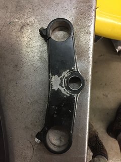

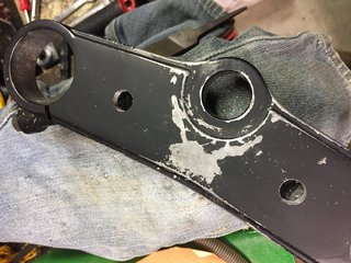

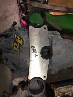

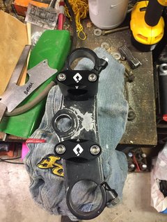

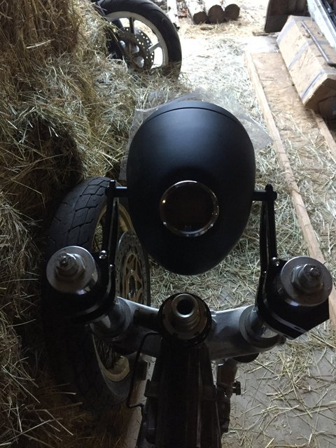

The top triple clamp metamorphosis:
The metamorphosis isn't visible.
is there a spacer on the clamp mounting bolts between the new plate and the tree? I hope so. looks great btw.  :cheerleader:
 :haw: thanks, man! There WILL be spacers, but I haven't made 'em yet. I have a piece chucked in the lathe for a triple clamp spacer presently. Getting closer all the time...
The soaking routine worked very well and every nipple unscrewed without incident. Last moment as a TDR wheel assembly:

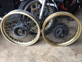

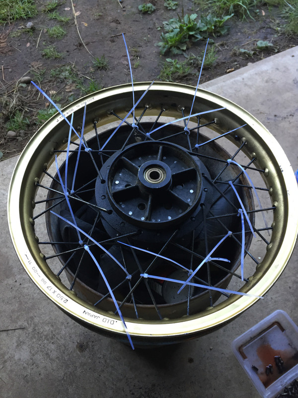

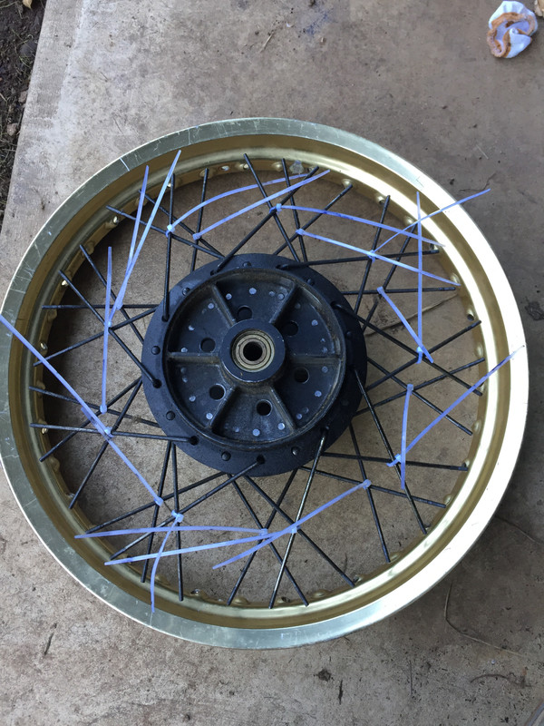

Got an Excel rim from my new best friend Mark (not that Mark) that I like better than the YZ item; it's much lighter and the color match is pretty good:
Excel on the right, with the sticker and TDR D.I.D on the left. And what it'll look like once the spokes get here and we lace:
Yeah, not the most dramatic transformation ever! Moving forward...

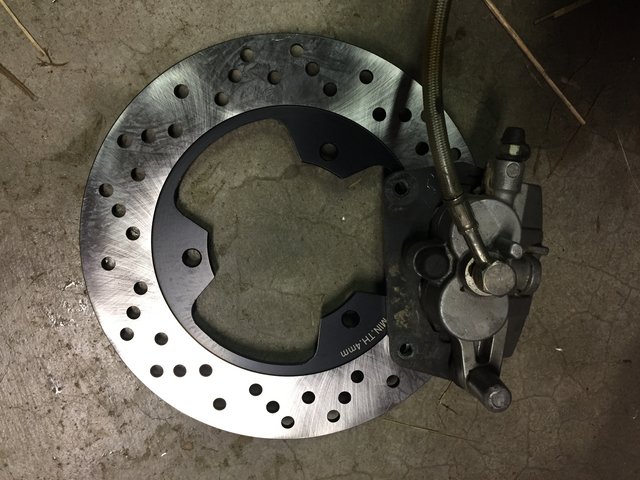

Good news: my rear brake disc arrived from China today
And it fits! Sweet. This is the caliper I'm considering:
It's from a quad, I think a Honda. I like the look of the line coming in the side, and a twin-piston setup at the rear will help make up for the feeble parts out front  :rolleyes:.
