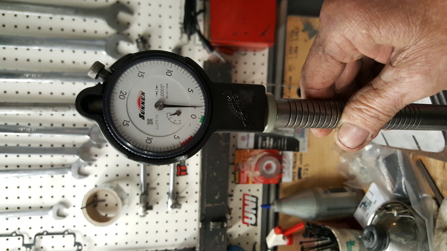

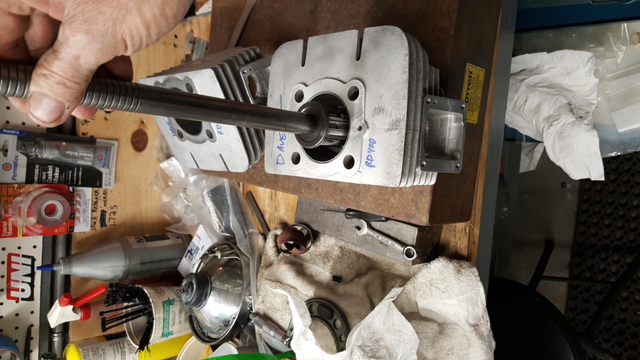

Could be your machinist didn't bore your cylinders to correct size.
When boring RD cylinders for size, you have to buff off the breakin coating Pro-X puts on the pistons with scotchbrite pad on the piston at the measurement location.
If you measure your piston on the coating you will bore the cylinders too big and cause wear because the cleances will be too big when the coating wears off.
I do use Quicksilver outboard oil synthetic blend on my RD's I build to set up on stock oil pump injection systems.
I'll post some pics...
Buff the pistons like this before measuring...
Set to .002 for streetbikes and .0025 for super hot street and roadrace engines.
Another tip on Pro-X pistons kits is throw the 2nd ring wavy expander in the trash, don't use it!
I set the oil pump shimming to .010-.011 as well up from stock at .008.
