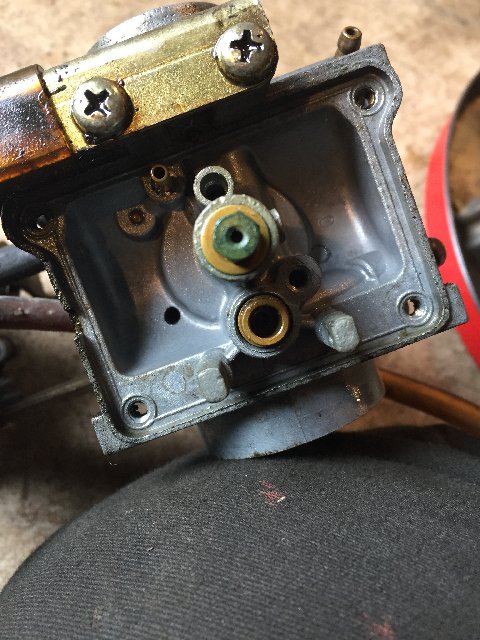

Hello, my name is Wade and I'm a bad two-stroke owner. I did some productive work today and felt it was time to take my wife's suggestion and get my RZ down from the lift and ready to ride to work. In my defense, I assumed the fuel system would need some attention so I started right in pulling the carbs out. Fuel tank: empty. Air filter: dirty. Carburetor bellmouths: dirty. Float bowl drains: open. Peering into the manifolds, I see carbon-fiber reeds. When did I buy those? Thought I had Boyesens.
Carbs off and on the floor (there's a story; I'll tell you someday when we have more time), they're generally grungy, the vent hoses have petrified and they smell faintly of stale gas. #2 phillips deployed and the bowls come off without a struggle, gaskets go in the trash. Interior of, ahh...left? carb is dry with a tiny bit of dusty debris in the bottom of the bowl. Meh. Next door, though...
Not my proudest moment. They'll be swimming in the ultrasonic cleaner Monday morning. Forgive me, Father, for I have sinned. Let he among you who is without sin cast the first sta-bil bottle...
It's true.
I really paid the price for my sloth this spring.
TDR carbs were full of that same green varnish.  PJ's clogged.  Air jets clogged.  Float needle valves stuck, etc.  Took a million kicks to start and then would barely run.
Started first kick after a full strip and jiggle in the 'sonic.  Has started first kick ever since.
