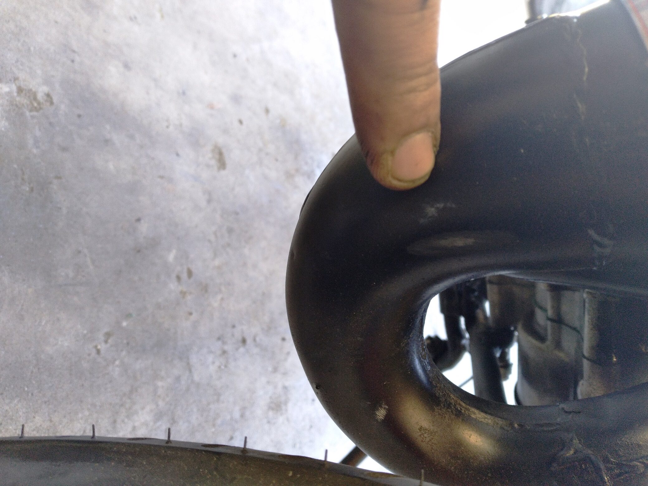

Slight update, i miscalculated and faceplanted on Saturdays test ride, the front wheel hit the pipe in a full left hander and stopped it dead and i lowsided at about 20mph in the neighborhood on the way to the gas station. Luckily didn't hurt anything including me. (and the fairing was off for the test.. whew.). it did hit the radiator but not enough to spring a leak.. and i had a new one coming anyway so no loss there. I gassed it up, rode it back home and re-clocked the head-pipe, rewelded and now have over 1" clearance at full compression and lock. I then took it back out and re-testrode, all good and motor breaking in nicely.

so heres where the tire hit the pipe:

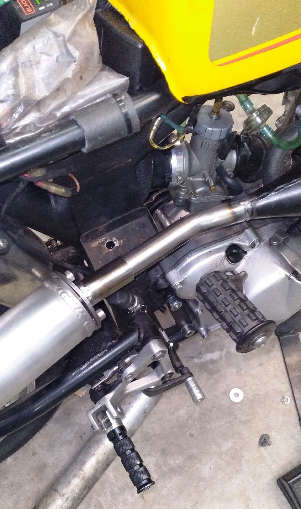

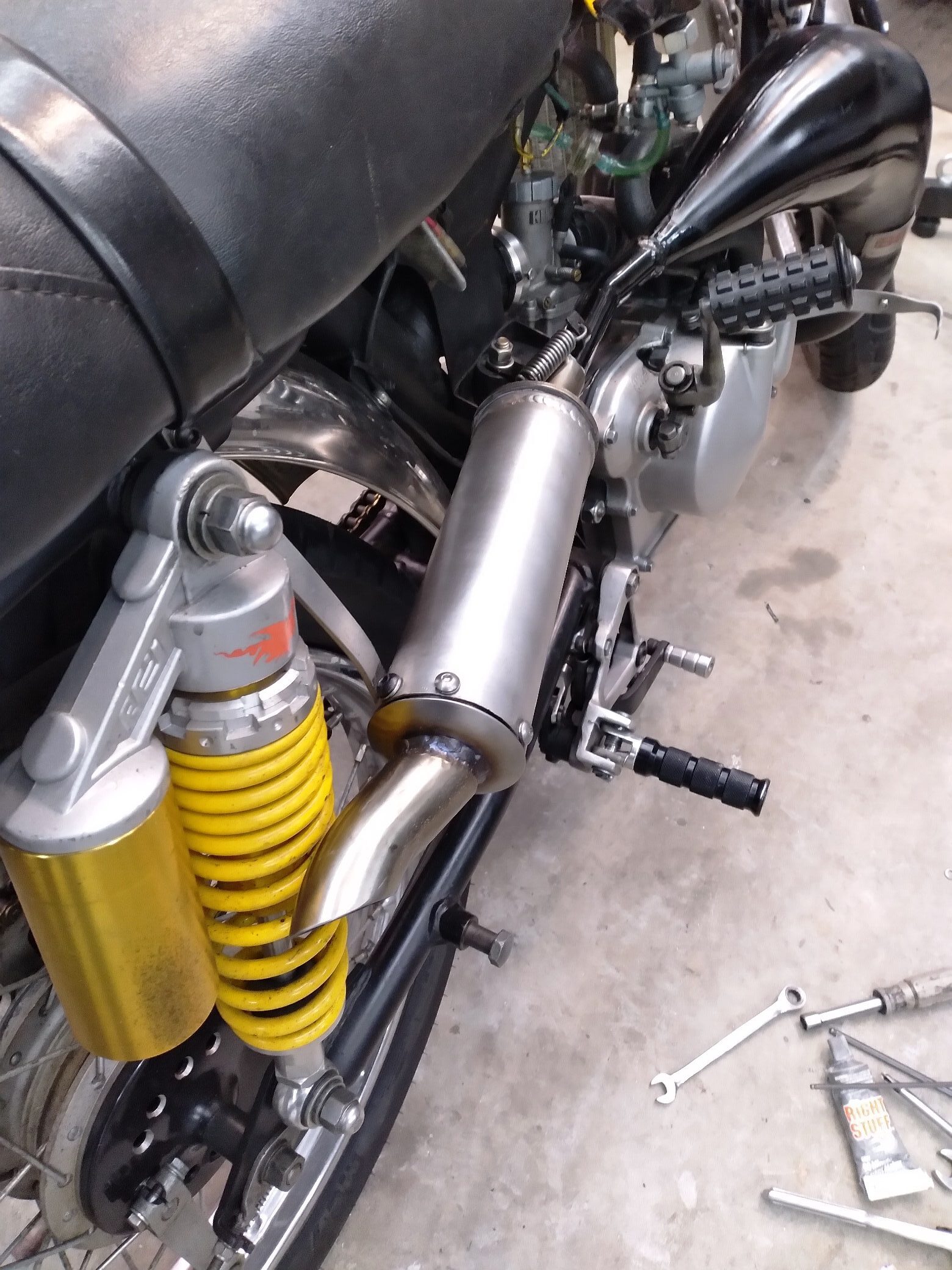

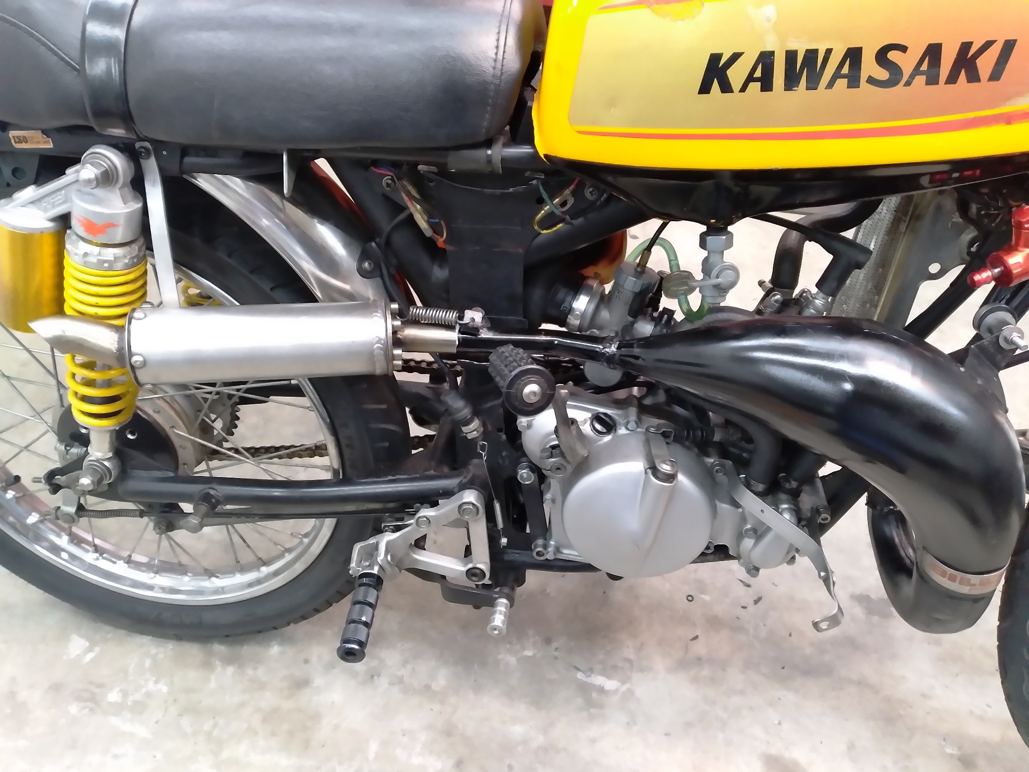

after modding the pipe up top as mentioned, the rear stinger just would NOT cooperate angle wise, so i just cut it out of the chamber and made a new one. also cut the end off the silencer and made a new slip collar our of stainless at a slight angle to get the positioning right.
the hole in the pate in one of th epics is where i mounted a machine isolator mount to support the back of the pipe, thats the old 6v battery box.
tacked up:
all welded up and sealed:
there's about 1/4" clearance between the silencer tip and the shock spring. genuine oh!-leans

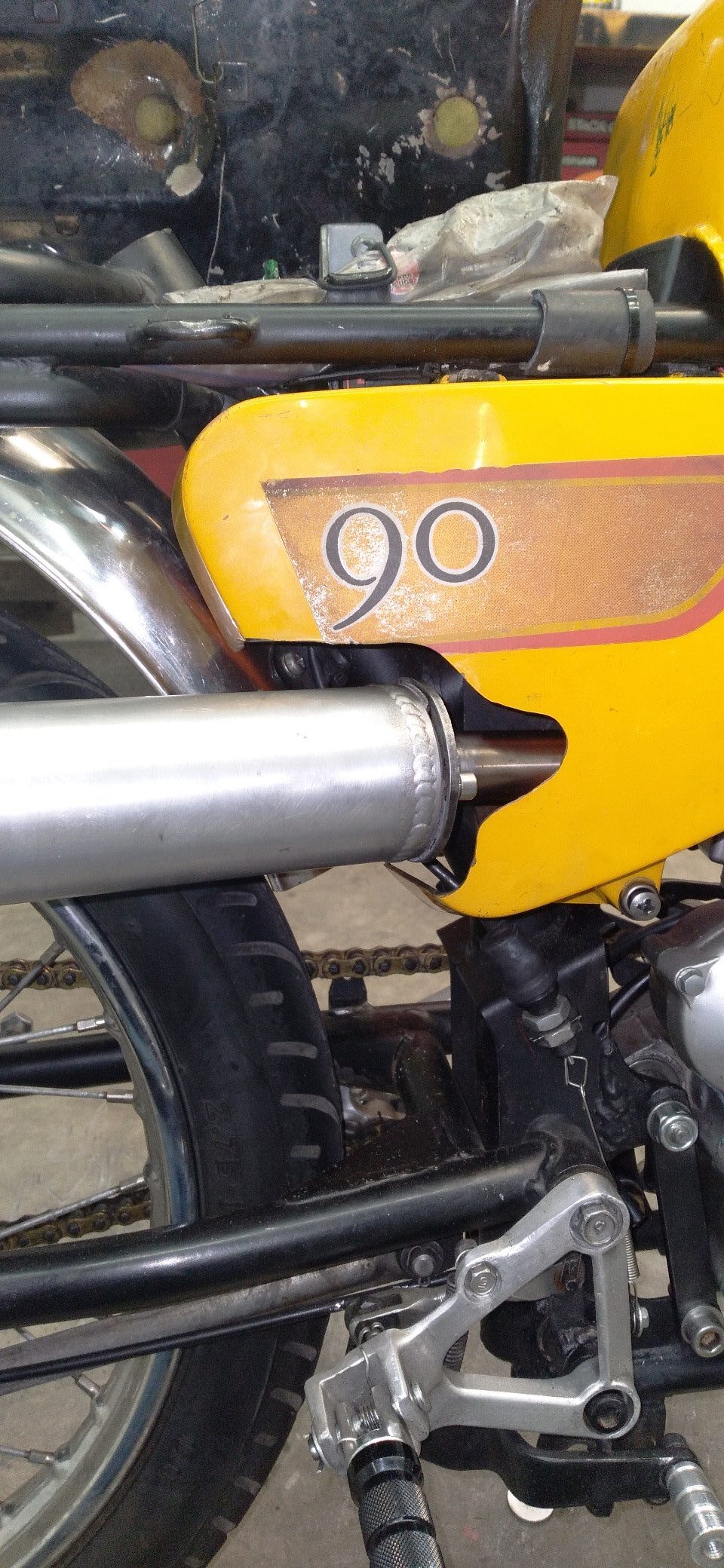

w side-cover mounted.
