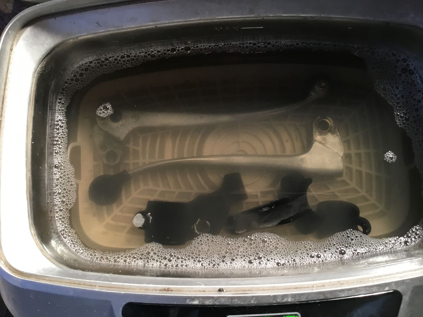

Stripped bars.  Tanked the levers before they get a fastener refresh.....
