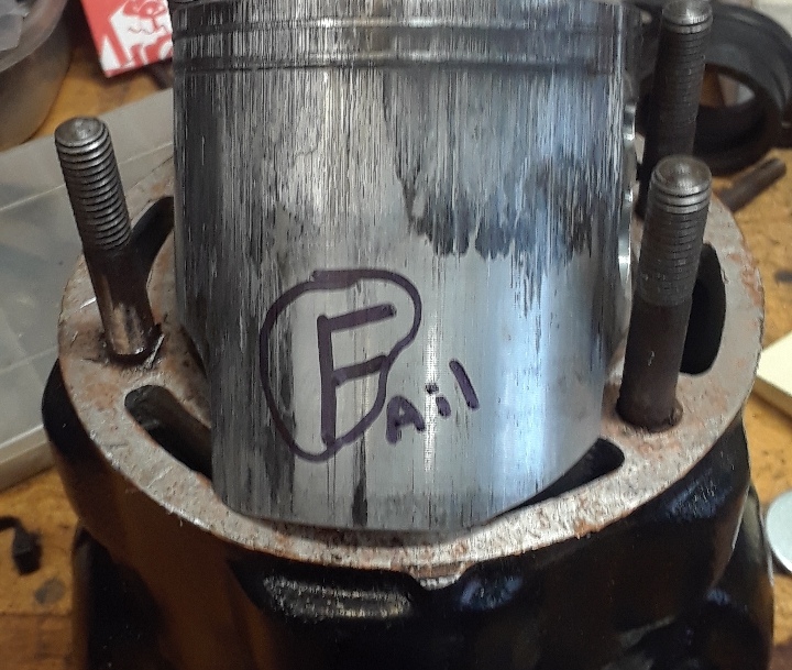

took head off, piston dome is perfect, only got hot at exhaust side, and quick. (the face). im thinking late timing, ive never seena motor go this quickly though. going to need a bore and piston though, the cyl is smeared around the exhaust port. IMHO, the only 2 thing son this motor it could be is timing, or a blocked exhaust, which im 99.99 percent sure it cant be since i took the whole pipe apart and rewelded it.  (but ive seen this with a broken baffle on a chamber before). sigh.  :toot:

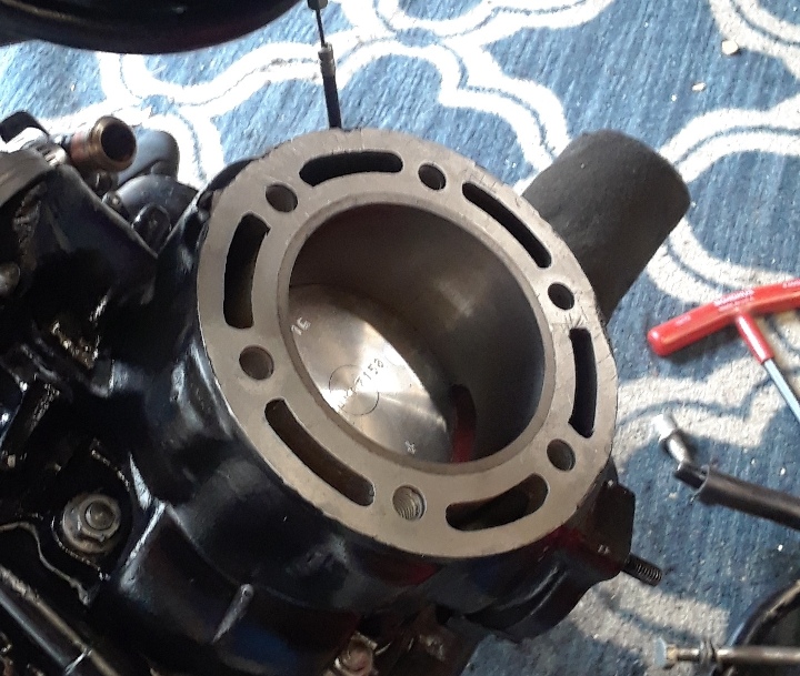

funny you mention that. I got it back together today, but its raining.  This was about an hour and a half? or so ago. test ride tomorrow but it sounds WAY better. timing sitting at 12 degrees at 6k, at 8 at idle.
THIS is what VERY  late ignition timing did to the last one. I had to move the plate 17 degrees  :eek: to get it to fire at 8 degrees at idle and 12 at 6k. so, im assuming the rotor i bought was 'off' as everything else was original to the motor. (i didnt have the rotor so i ebayed one and burned myself not verifying)
new and fresh this morning:
