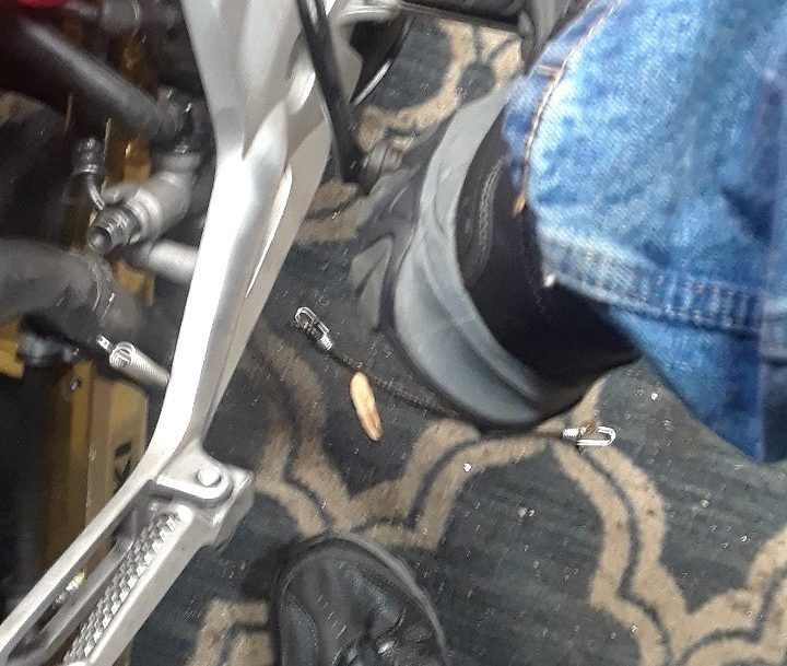

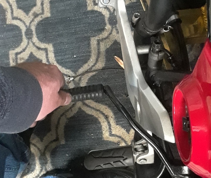

small update. rain day mods. had to rework the angle on the kicker. its still a bit awkward but not nearly as bad. used the end off an old worn slap out and bent rd kicker to make it easier on my foot as well.  was slipping off and wheel was catching on passenger peg mount, was just terrible.

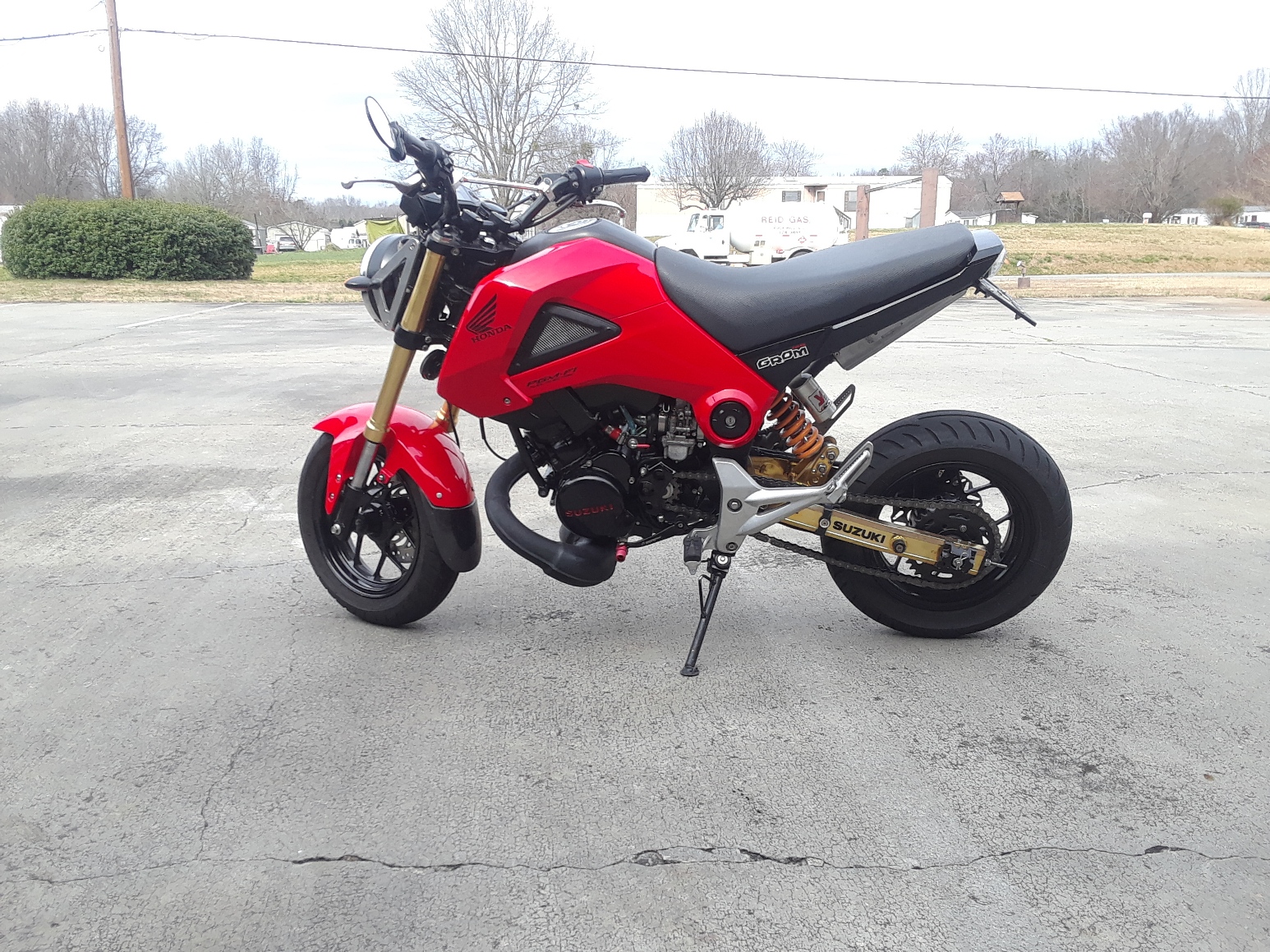

and, 1st commute complete.  :cheerleader: :toot:
I added in a remote coolant tank last night, swapped in a speigler front brake line, and just tidied up this and that. Its really good but i need to absolutely need to go down on the rear sprocket.
1st  just runs out super quick, and i physically have the largest from sprocket on it i can fit.
coolant temps stayed around 140-150 on way in, might need to drop the main a touch as well, when you let down off the throttle at WOT a hair it picks up speed a bit.. Better to err on the side of rich but i have some legroom i think.
overflow, machined aluminum filter body we make at work, mounted tot he stock lower exhaust mount hole with a parker quick connect . breather tube at top. some rando clamp i had laying around, looks like an exhaust clamp for a 4 stroke.
