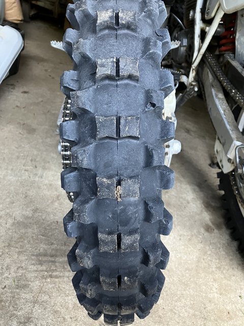

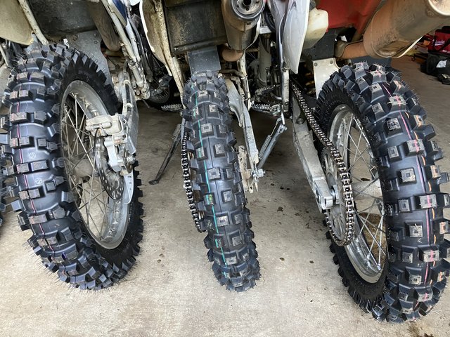

The things I do for my kids! Time for new knobbies, and I've put seven on in the last week; two skinned knuckles, but no pinched tubes! All three boys have new rubber, as well as my buddy Ron. Maybe this should have been in the 4-stroke blasphemy category  :whistle:
My bike has gotten no love. That Michelin is a soft-terrain that's at least 15 years old, but it won't wear out! I have a set of gummy Shinkos waiting in the wings for it...maybe I can change two more tires without snake-biting a tube.
