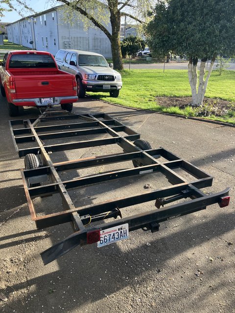

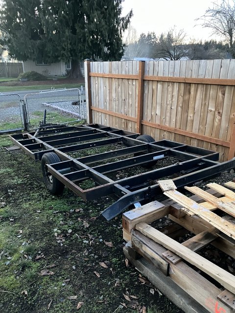

With all the house, garage, bike and mower projects, I needed something more to work on, so I bought a trailer. Needed something to haul riding lawnmowers from time to time, as many as four dirt bikes at a time and who knows what else? This was a Jayco tent trailer once upon a time, but now it's a 7' by 11' frame needing a deck. I am leaning towards wood, and a friend who works in a mill can get me free lumber with a catch: it's not long enough to run lengthwise. It's more or less 2x6 boards, but it's 3-ply laminate with a finished thickness of 2 1/8". So here's my question: is there any reason besides basic weirdness not to deck a trailer with boards running side-to-side? I'll have to buy lumber if I'm to run the boards lengthwise, and I'm notoriously thrifty, so the free boards are appealing to me. What does the hivemind think?
As cheap as steel is now I would wast my time with wood.
weight. me? i'd use marine grade plywood.

I have considered expanded metal, but it would need additional supports welded in (I just don't want to) and I like the idea of wood for aesthetics.
Quote from: m in sc on March 01, 2023, 11:13:33 AM
Hmmm...plywood, you say. Worth a thought.

Your trailer is framed for the boards to run length wise. If you're keen on using the free wood, couldn't you just add one more wide metal brace in the middle and butt the ends of the boards together? You'd have a seam in the middle, but if it's bolted down good towards the ends it should work. You could even get fancy and put a length of T metal in the seam to cover it.

Sometimes it takes just the right comment to get me to think about a thing a little differently. I just checked Home Depot's site and 12' 2x8s are $10 and change...about $120 to just shut up and buy new lumber. The problem is getting 12' boards home in my short bed Tacoma   :Clown:

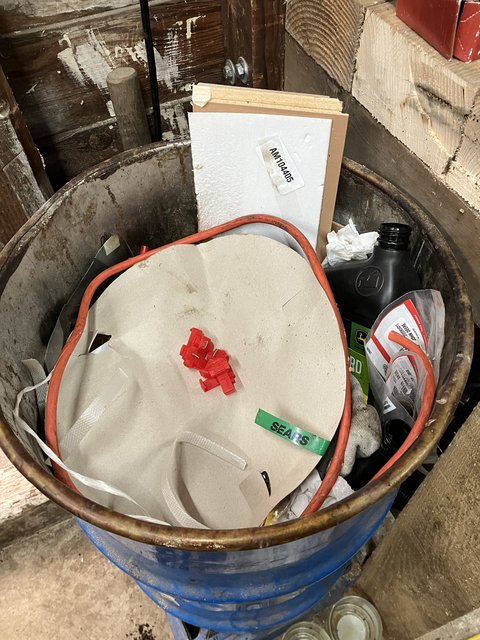

The wiring is done!
I think I used the connectors from the lighting kit correctly

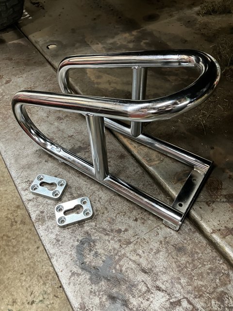

I bought these as well as a couple of extra mounting plate kits
Three dirt bike width and one street bike
Quote from: 85RZwade on April 27, 2024, 04:18:58 PMI think I used the connectors from the lighting kit correctly
If you refer to the Mark Haase edition of the instructions you did that step correctly. :affirmation:
Yeah, I despise scotch locks except for an emergency repair.  :rant-1:
