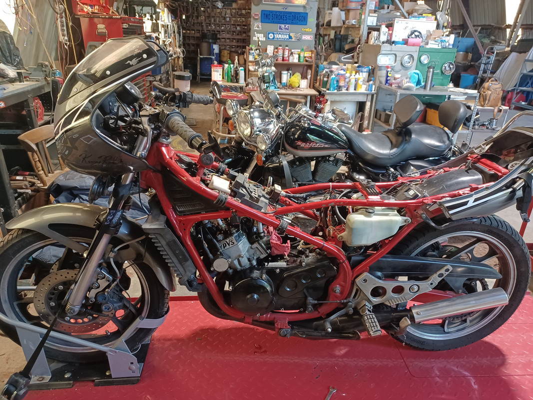

Yep. Athena based. Wicked pipes. Not sure which carbs yet.
All-inclusive 421 kit made for RZs ordered from AZ quads. Supposed to be here Thursday. Pipes from Wicked are next, then decide on carbs. Leaning towards 36 MM Lectrons or Smart Carbs, but damn they are pricey...
Disassembly continues.
After further study and a consultation with M in SC looks like Kehin PWK...

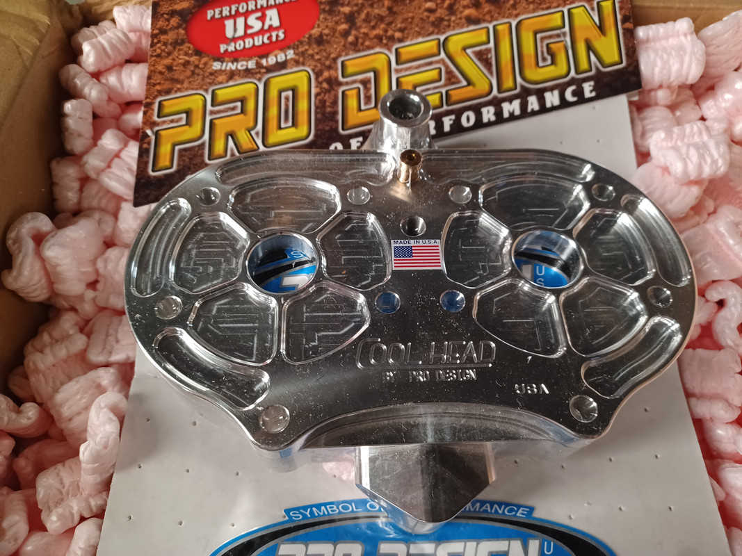

Kit arrived today. This version has the temp sensor hole for use in a RZ. Also coordinated with Gary (Arrow) on the RD LC Crazy forum in the UK to do his magic 421 pump rebuild and upgrade.

Snagged a set of new Keihin PWK 35s set up for this build. If I can ever get Roger on the phone, I will order the big bore stainless steel pipes.  Research indicates center stand has to come off.
