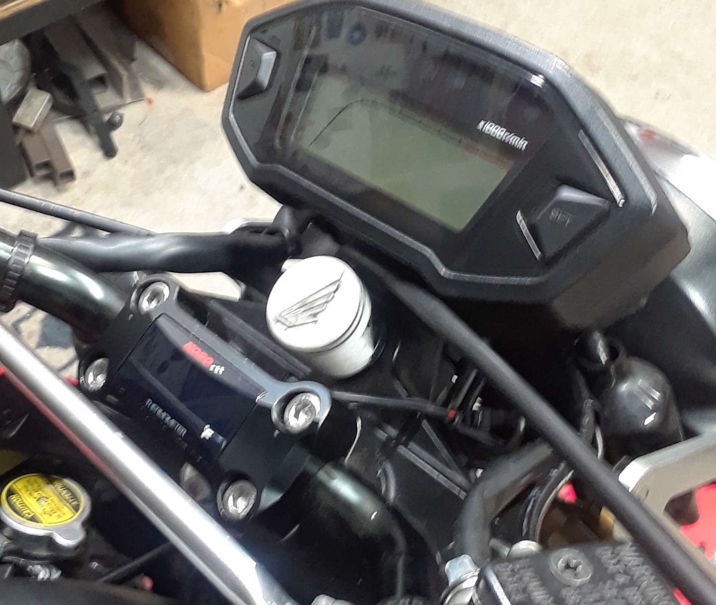

small update. fit an in-bar clamp flush water temp gauge from koso.
cleans up the look a bit.

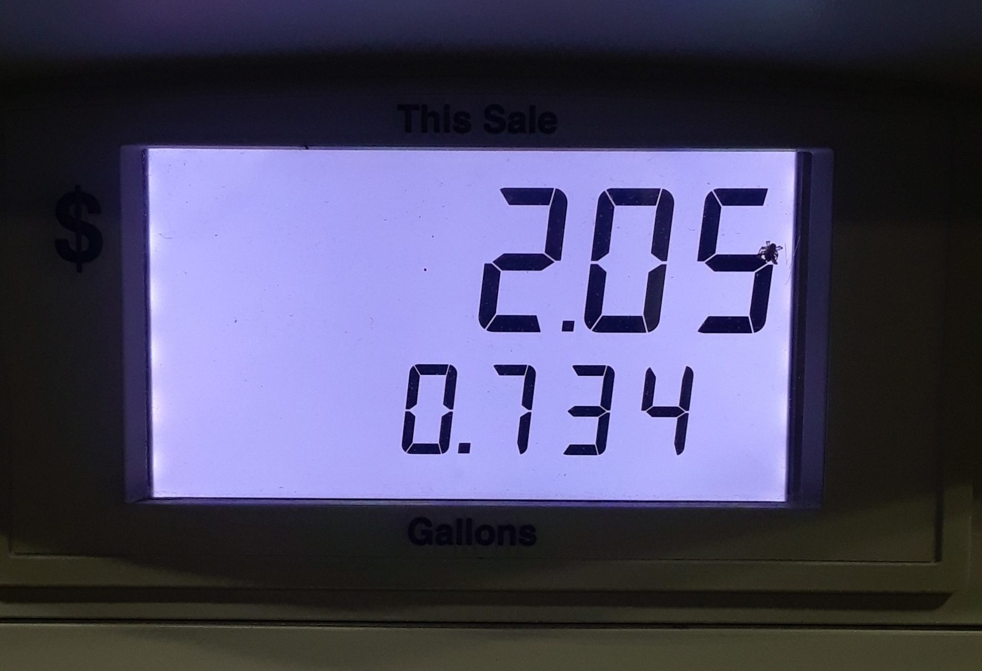

also, did mileage runs monday, this was pretty typical, mixed riding.  31 mpg.

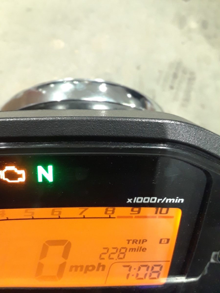

I did a good long ride on it yesterday. zero issues for about 2 hours mixed riding, real world. ran through over 2 tanks of fuel. between final carb tuning and changing ratio to 40:1, i yielded 38.2 mpg.  :haw:
water temp out of the top of the radiator never went over 148, was 65 here yesterday??.
Im pretty happy with this. By comparison the fuel injected 170 4v was somewhere in the ball park of 42 and lived over 7k all the time.

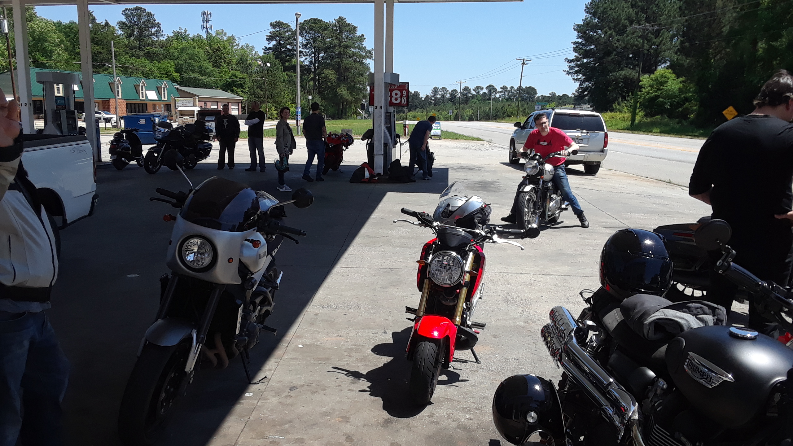

as a follow up, did a group ride sunday. 2 hours? or so, close to 100 miles (we of course made stops).
hit 85 at one point running down a  triumph scrambler, surprised him pretty good when i passed him.
good day, zero issues, 34 mpg, water temp never went over 172, was 80 degrees out..
