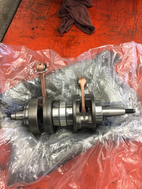

I have been acquiring parts for this build lately, and mulling over some decisions, such as rebuild vs. replace crankshaft, or just run the one I have. Most of you will approve of my decision:
New assembly from Norbo via a member on the RD/RZ site. Bottom end cleaning and assembly can begin, and then I can figure out what to do with my cylinders...and head...

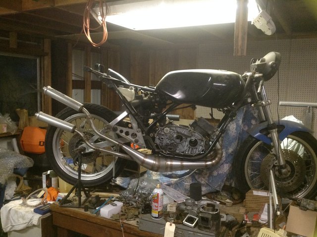

I have been pipe dreaming of late. Still like the look of these RG chambers for their chunky, almost-original-TZ look:

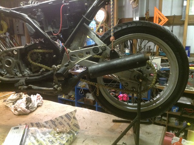

Tried these old Lomas pipes on for giggles; they're destined for my 2nd RZ350 project, and I think that's a better place for them. Ugh.
To be fair, I hung them pretty hastily, so the (Toomey) silencers are cattywampus instead of parallel. Just not the look I'm after.
I picked these DGs up last year from Whymee over on the RZ/RD site without a clear plan for them. They're in excellent condition and I think they look good on the LC, so I plan to use them first as a somewhat known quantity for initial tuning and ballpark jetting.
I see a lot of difference in overall length. My thought is to use OEM LC headpipes married to the RG chambers, so I need to re-read some expansion chamber theory to see if some additional length would be desirable. Maybe I'll find that the Suzuki pipes aren't suitable at all!

I think the DG RZ pipes look the best but I'm thinking they won't work very well because they are for a YPVS engine.
^ I agree.  Never been a fan of the looooooooooooooong stingers on those JL's.

Joe, I wonder the same thing. I've read multiple places that RZ pipes fit LCs, and the ones I have more or less do, but they're not the same engine, just similar. Maybe eventually I'll get out the big wallet and put a sweet set of Tygas or some such on her.

(as I understand it) RZ port timing is quite a bit different than LC/aircooled, and RZ pipes don't really perform well on the older non-YPVS cyls.
I only have the bitchin' stainless Garrett pipes on my LC (which were designed for aircooled port timing, so should work well on LC) because he made me a deal I couldn't refuse.  No way else can I afford anything this nice.

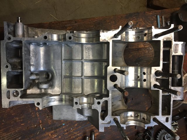

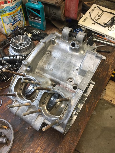

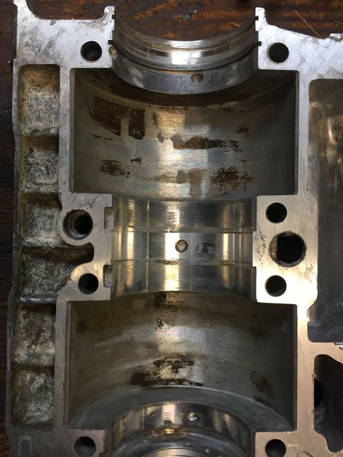

After most of a work day in the hot parts washer, going around and around, they're pretty clean.
But there's still some work to do...
Debating with myself whether to paint the cases or not. Does anyone know if a portable sand blaster can be used with soda? It was suggested to me that it's just a matter of a different tip in the gun.
