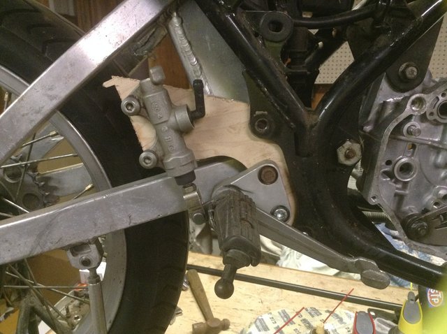

I'm supposed to be doing other things today. Right side mocked in plywood:
Can you tell that the left side is 1/2" lower? Me neither. Hooray for eyeball engineering  :cheerleader:
I'll work on getting a seat on there and see which side I like better. I read somewhere about making your worst mistakes in cardboard (wood, in this case).

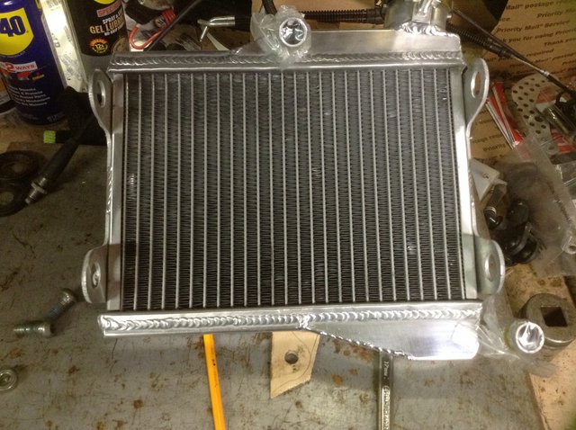

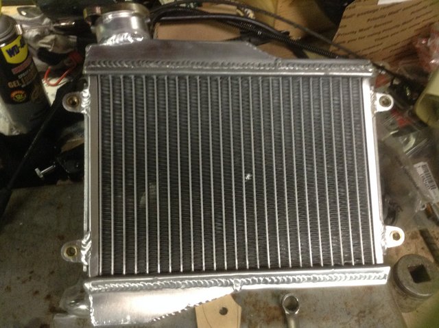

Honestly, I was just looking at coolant hoses when I found this:
$78 including radiator cap and hoses. Three rows, all aluminum construction. I couldn't say no.

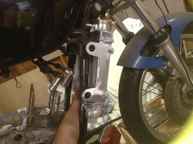

Seems to fit perfectly. I don't think the Elsie is known for cooling problems, so this is just fun bling. I might have to put a thermostat in it now...I have seen the Elsie radiator suggested as a replacement for the RZ350, so maybe I'll do that. Or buy another $78 aluminum radiator for the RZ!
I fitted one of those rads on my hybrid bike, with a bi of added bling. The cover is for an LC and seems quite a bit bigger than the rad so I was wondering if the rad is actually smaller than a stock LC rad.
I had to add a fan this summer as it was overheating, but my motor is far from stock.
i have the same radiator. it works great. no thermostat needed just fyi.  you can get the same one in rz configuration (or could).
I have a small fan on my hybrid. it never needs to come on, its set for 210 degrees 'on' @ the head. my coolant temp gauge is in the upper hose, just fyi. make sure you test fit with chambers on.   :twocents:
