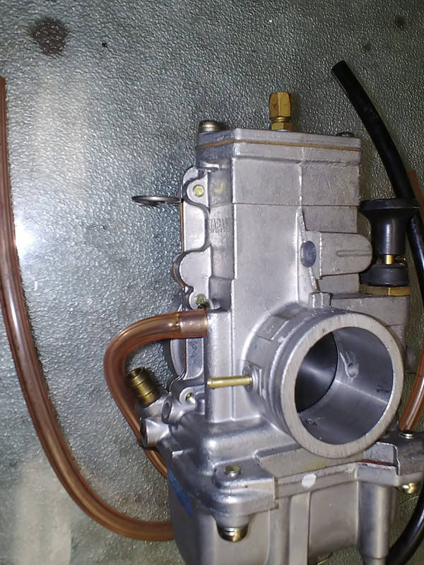

My good friend Frank B came over day before yesterday and we started prepping our TM32s for installation. We used 3 MM OD brass tubing sourced from McMaster Carr for the oil lines and a 7/64 (2.7 MM) drill bit. We had to ream the holes just a bit and then a drop of red loctite and Bob's your Uncle.

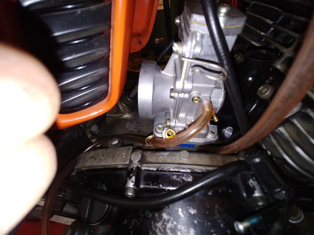

Playtime was limited today. I got one side disassembled and the reed block cleaned up. Did a quick mock up.
It fills the hole up. Air filters will be close...

I got initial jetting specs from M in SC ( Thanks Mark!!) and ordered the brass from Niche Cycle.
Main 230
Pilot 40
Stock needle
P6 needle jets
Clip will be in the middle and air screws initially at 1.5
I also ordered some P4s and received a set of TM28 slide springs. The latter should help with the throttle effort and save my old wrist.
 :clap: new shiny bits look nice tucked in there  :bacon:
