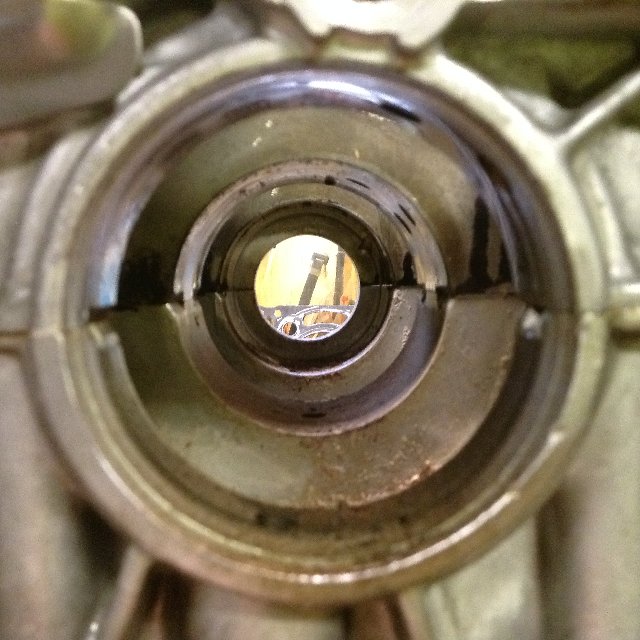

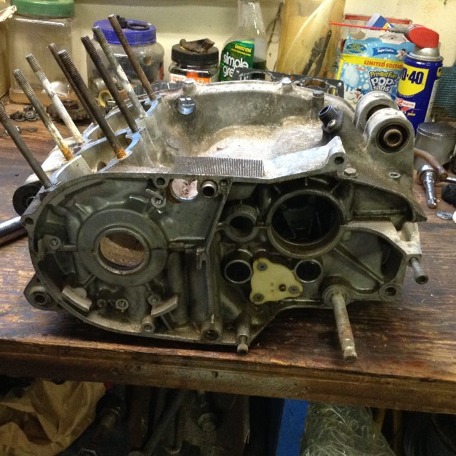

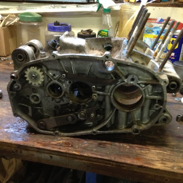

I married the LC top case half to the RD bottom half as suggested by Mr. Spooner, for the purpose of establishing engine mounts:
I suppose it's more of a date, as nobody expects them to stay together...the whole coolant thing
Near-perfect fit, as advertised. Reminds me of parts-bin engineering, and I mean that in the most respectful and admiring way.
Is anyone else thinking "Bond movie"?
Pretty cool how they fit together isn't it?
Yes, even though you told me what to expect it was still a cool moment to see how well everything lined up. I was thinking "I could almost put shafts in there", but the countershaft bores are off by about a millimeter.
