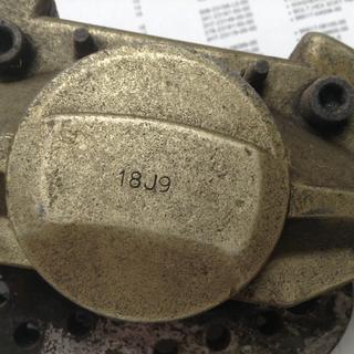

I started this morning by harvesting some parts from one of the donors, including the front brake caliper I intend to use. Before I crack this thing apart, I'd like to know that I can source replacement parts...
Does anyone recognize this Brembo? I can tell you it was non-standard fitment on an '83 TZ250K.
Any recommendations for a replacement parts source?
Thanks, Wade
Looks like a P108 fitted to some Paso's.
38mm pistons are probably the same as an F08 which were really common.

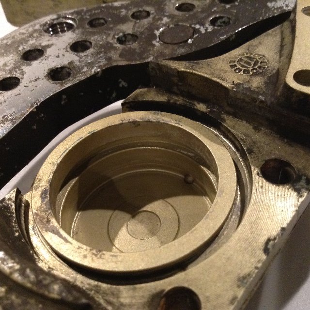

It came apart nicely and looks a little better after a trip through the parts washer.
The bores look nice below the piston seal, but there's a little corrosion above the seal (nearer the pad).
I found pistons and seal kits nicely priced at oppracing. In the meantime, more cleaning and I may pop the other caliper apart to see how it's condition compares.

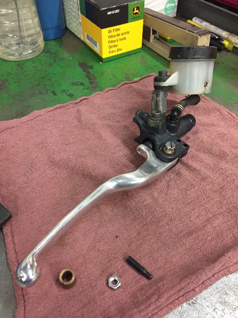

Front master cylinder arrived today, and although it doesn't say much for my research skills, I am happy to see it is a Brembo rather than a Grimeca. Finding a kit just got easier.
Wade
Lever landed on my bench today, and it's a peach. Fits the master cylinder, and I'm working on a pivot bolt.

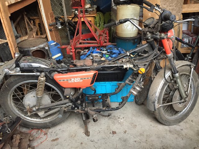

How about the rest of the bike............got any pics?

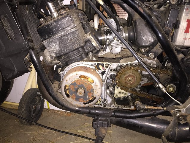

Point taken! Not much is assembled yet, but here's the plan: start with this '75 RD350
and update it...at least a decade or so, with a water-cooled '82 RD350LC engine
and suspension and brakes from an '83 TZ250K

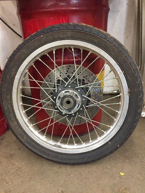

I'm using a single disc up front, so I removed one from the wheel
I was surprised how heavy the discs were: 5.23 lbs solid, 4.73 lbs drilled. Drilled disc it is, then! This bike came to me with the Brembo 2-piston calipers above, so I'll make one out of the best parts and the new pistons and seal kit. Here's the Brembo master cylinder and lever
Hopefully the braided brake line can be reused, but we'll see if everything lines up correctly.
Looks like you have a good start. I'll give you a pointer on using that LC engine in the RD frame. Im assuming you will be rebuilding the bottom end so it will be split and it needs to be to do this anyway. You can take an AC bottom case half and an LC top case half and bolt them together. You can then put that in the AC frame and the bottom front and bottom rear mounts will properly align the engine while you fab mounts for the LC engine since they are mounted by the top case half only. Once you have those mounts fabbed you can put the assembled LC cases in the frame and cut away the unneeded mounts from the AC engine and also fab mounts for the tie bars if you plan on using them. This is how I did mine since I am using an LC bottom end in a TR3 frame (same mounts as an RD).

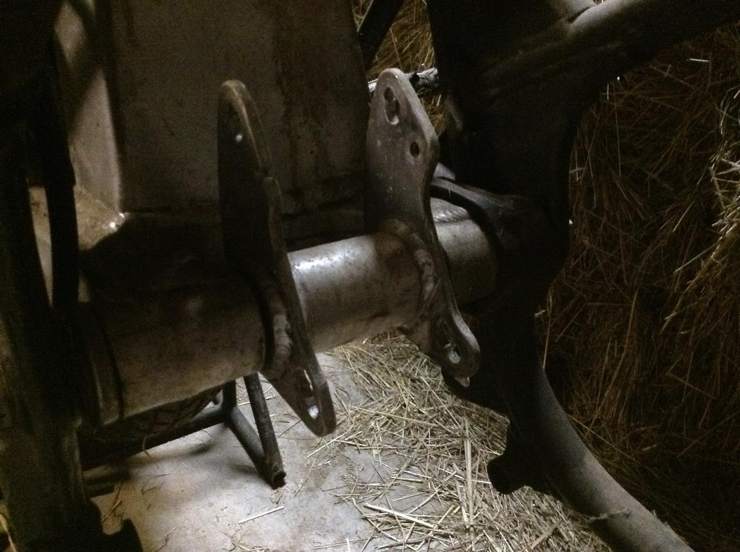

Awesome, thanks for the tip. I haven't looked closely enough yet to know if I'll be able to mimic the TZ rear engine mount:
It might be hard to see in this crappy picture, but the rear engine mount is concentric with the swingarm pivot. If it doesn't conflict with the AC frame, I'll fab one suitable for the LC cases. I think. :umm:
Next time I'm out in the shop I'll take some pics of my mounts and post them.
