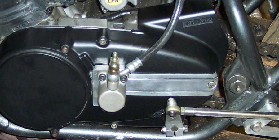

i quite smoking years ago. thats how old this pic is. lol.
still on there but with stainless line. this was earlier this year.
was a ducati slave, aprilia? master, is a direct bolt on./ had to make rod extension. thats about it.
as luck would have it, i hate the plate i made, and plan on machining a cosmetically better one. i'll pass on the info when i do it. will be sooner than later.  did all this by hand, didn't use cad at all. and i'm proficient in acad, sw, etc.

IF the cnc mill we had here  still was online id make a batch, but its not. that ridge on the cover is the MF

Instead of making the adapter plate as a bridge to get over the ridge in the side cover, would it be easier to mill a flat through that ridge?  Might be six of one and half dozen of the other, but a flat surface might be simpler and stiffer.
covers not flat and its thin there. the ridge is flat(ter) though. and, it doesn't trash the cover. ;)  I did an earlier one with a nighthawk master and slave, and milled the cover. didnt really like it. still have it languishing somewhere, i think, maybe.
