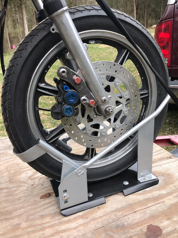

When you don't have a mill...  Not perfect, but not bad! Took me a while to make though. The caliper really takes up a lot of space between the forks. Looks like it will hit the wheel. Hopefully an optical illusion.
Quite impressive. That looks really nice.

Quote from: JBeasty on March 29, 2023, 03:33:40 PM
Nice work on the caliper bracket,

Thanks everybody. I can't take full credit. This is Marks (m in sc) design.
http://www.2strokeworld.net/forum/index.php?topic=184.0

More from the Neanderthal machine shop! Center of stock rotor to align new disk to caliper.
EDIT: Question for Mark - This is only about 10mm (or 0.4") thick. In your SPEED SHOP post, you say it should be 13mm (or 1/2"). Will this work, or can I space it out a bit more with washers? I guess I could mount it up and see for myself...
1977 RD400
agreed. if you cant shim the caliper in any further, and have it clear, you will need to make a 2-3mm shim behind the spacer, aluminum will be fine for this, ut im pretty sure you can space the caliper back and get it to work.

Got it. I'm guessing I shouldn't use washers to shim the caliper either?
1977 RD400
you can use washers or spacers to shim the caliper, thats fine. 3/8" id ones will work, you may want to get some thick washers or spacers for final use if that works.
