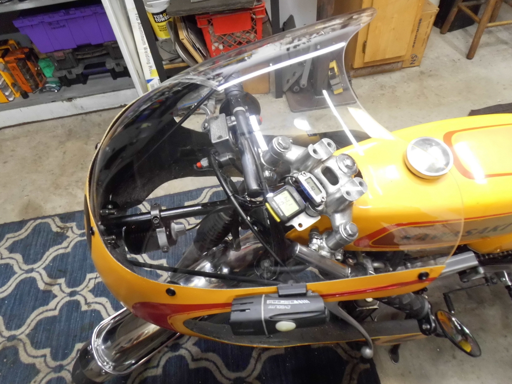

lost the build thread ont he old site, but this started as a stock scruffy 71 G3ss and after getting tired of the trans problems and lack of power,  i stuffed a CR85 motor in it, then it got out of control.  :metal:

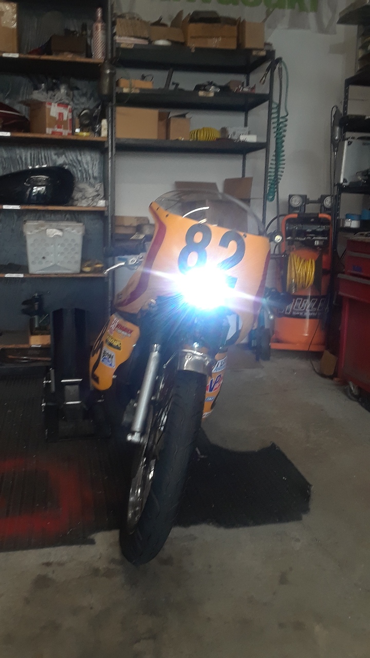

heres the current updates, dropped down to an 11mm master, redid the fairing stays, and changed out the led headlight. This is all powered by a 20v drill battery as theres -no- charging options for a cr85 motor.
this will do about 80 mph with me on it, thats a kreidler fairing from treatland.

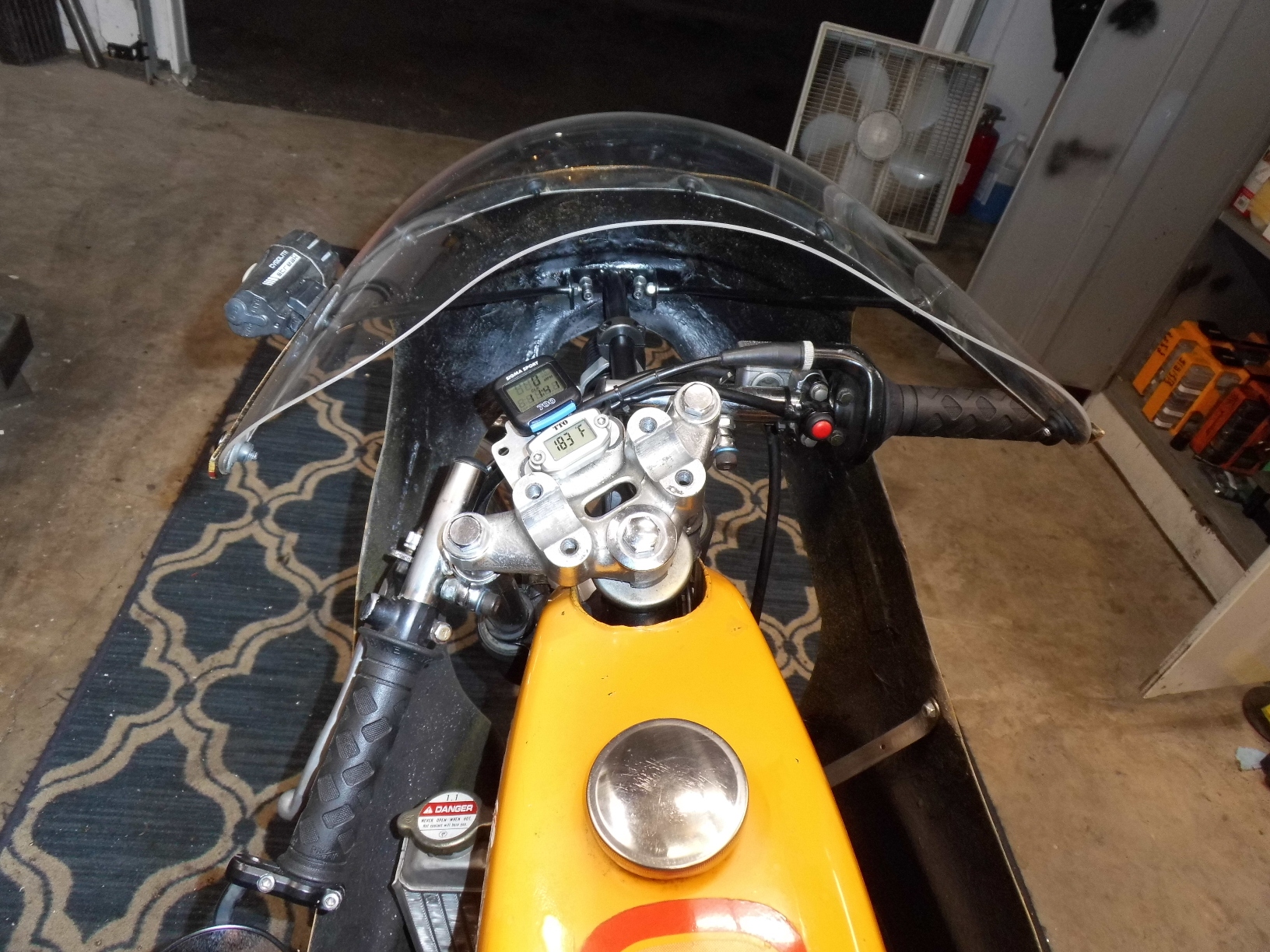

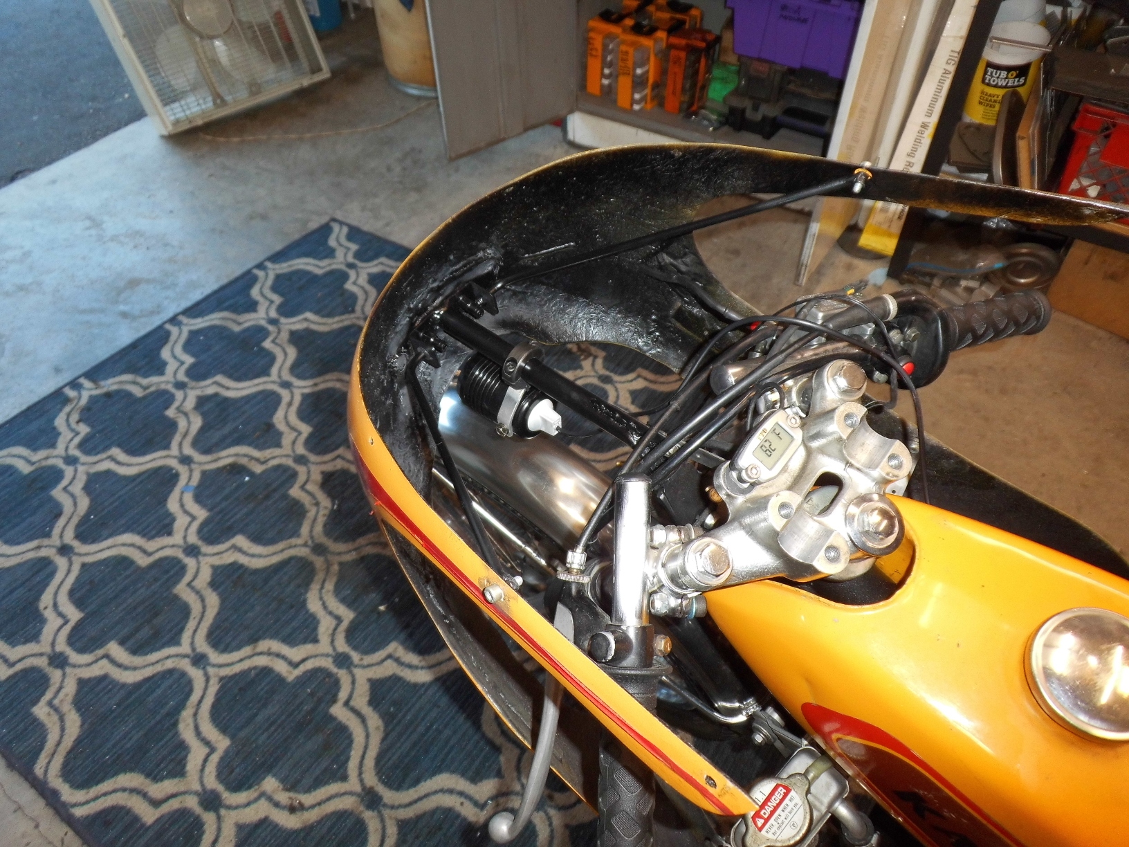

new rods made, threaded the bar at the fairing end, welded m5 nut at top to hold in place at fairing, threads through screen shield.

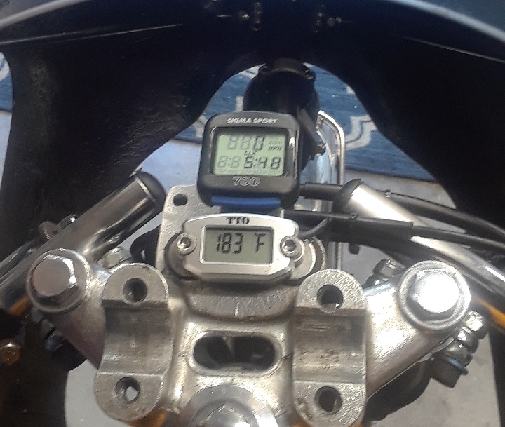

gauge plate. hole to left if for headlight mode button, on way.

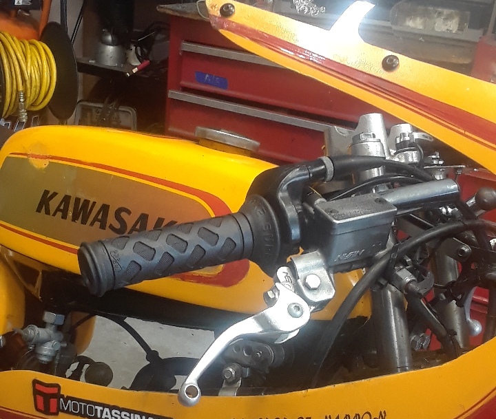

brake master off a kx 85, with hydraulic banjo brake switch

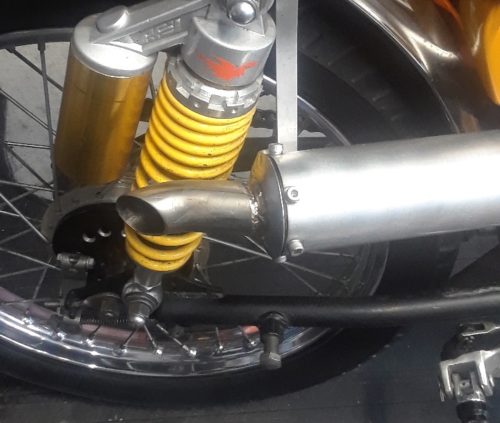

remade silncer tip out of stainless, also welded in nuts to can to use bolts instead of rivets.

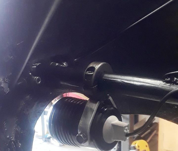

cyglo mtn bike light for 'just in case' situations wher emore light is needed. this thing is stupid bright, ive actually ridden the gap, at night, with just this headlight.

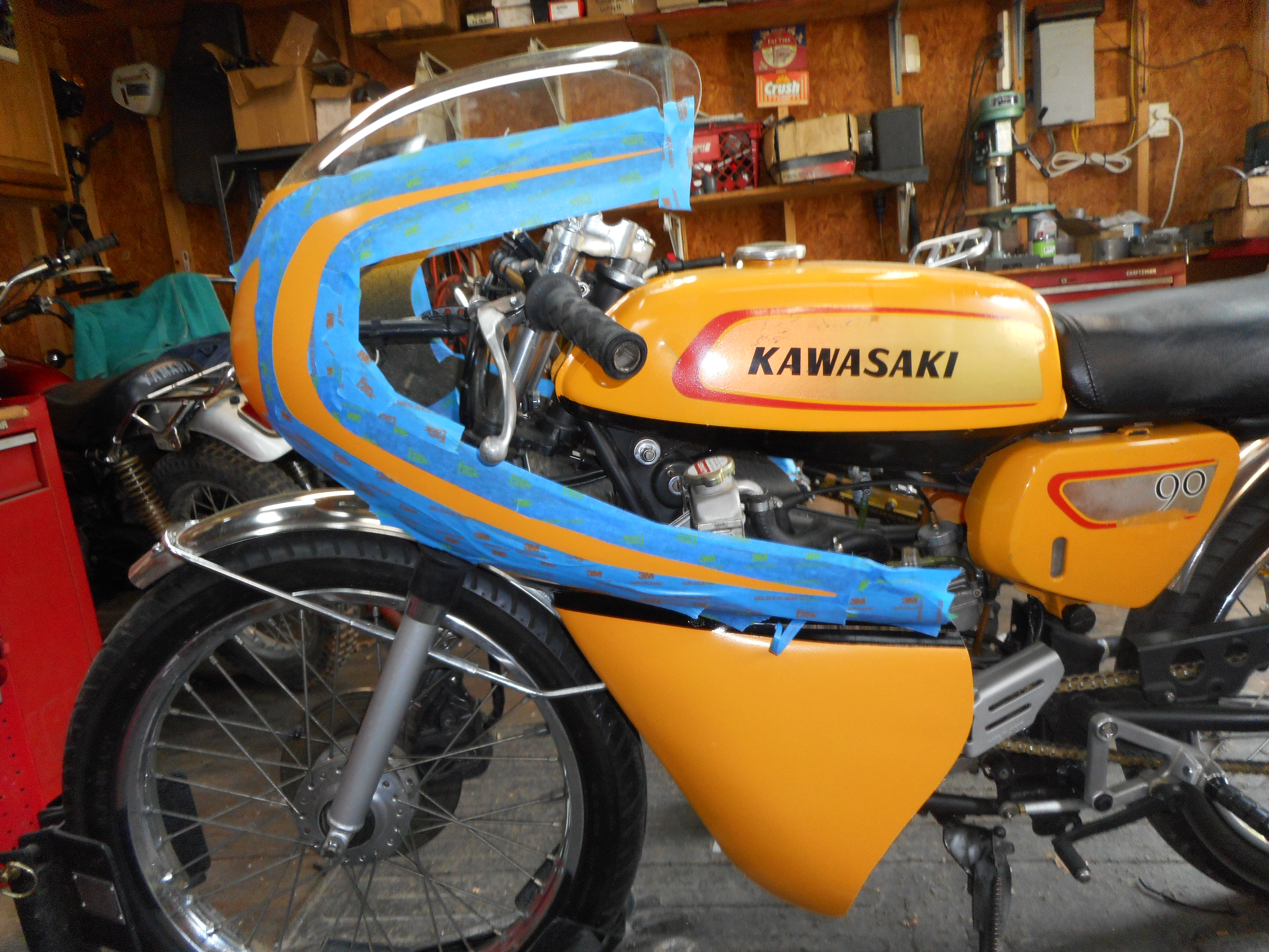

That thing is so cool! :metal:  Love the 70s color theme on it. How did you find a fairing that matched? Did Kreidler just happen to have nearly the same colors/graphics?
Quote from: SoCal250 on August 08, 2019, 01:30:38 AM
Thanks guys.   :toot:

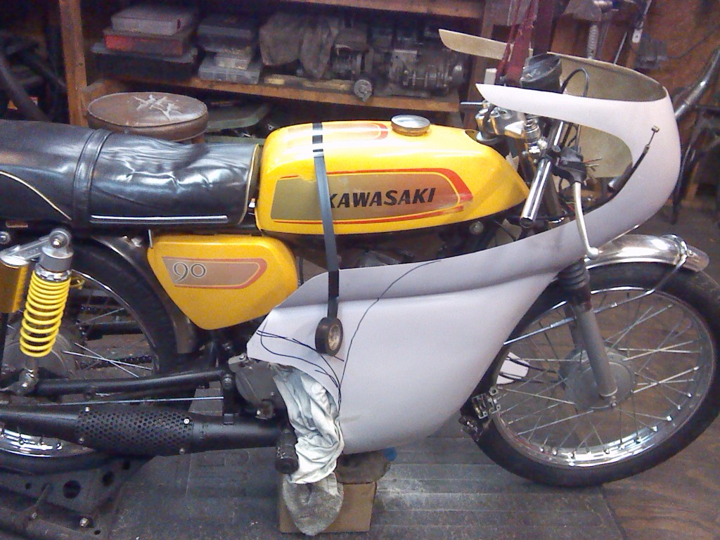

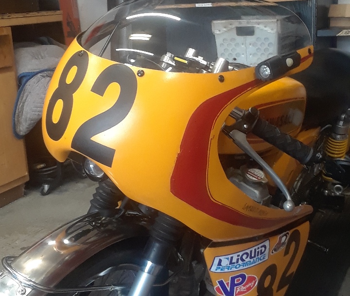

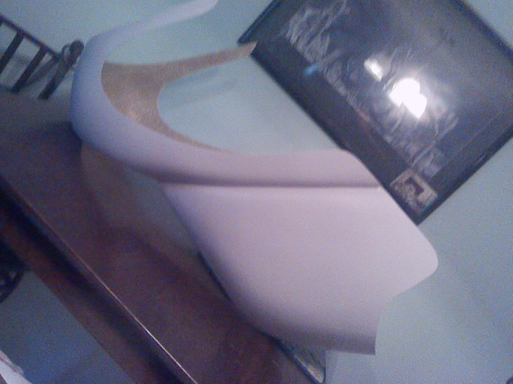

i wish it came that way.. wasn't even close, (which is fine) i had to section the sides and add about 4" (under the clipons its longer). after i cut the sides out a bit, i used that fiberglass to lengthen it, theres a support plate glassed in behind the skin as well. so, the sides were brought way up, long narrow part was lengthened , bottom was widened. the core of it was the right size, thats why i went that way.
My goal was to make it match the original paint, so i had the local body shop match the yellow color to the side-cover, and i sprayed it. then i did an intentionally rough paint job, including the sloppy stripe, to look like ' a guy that basically lived in his van and raced it, around 1975' look. it was harder than actually stripping everything and doing a pretty paint job. well, more time consuming.
as i received it: (it was brand new)
test fitment pre cut:
sprayed and cut (i painted the base yellow as well)
intentionally crappily laying out the stripes  :haw:

Bravo! :clap: You had me fooled. That looks like an old 2nd hand fairing that just happens to match. You did an awesome job making it appear to be authentic 1970's!   :affirmation:  It looks really good on there with the mods and paint match.

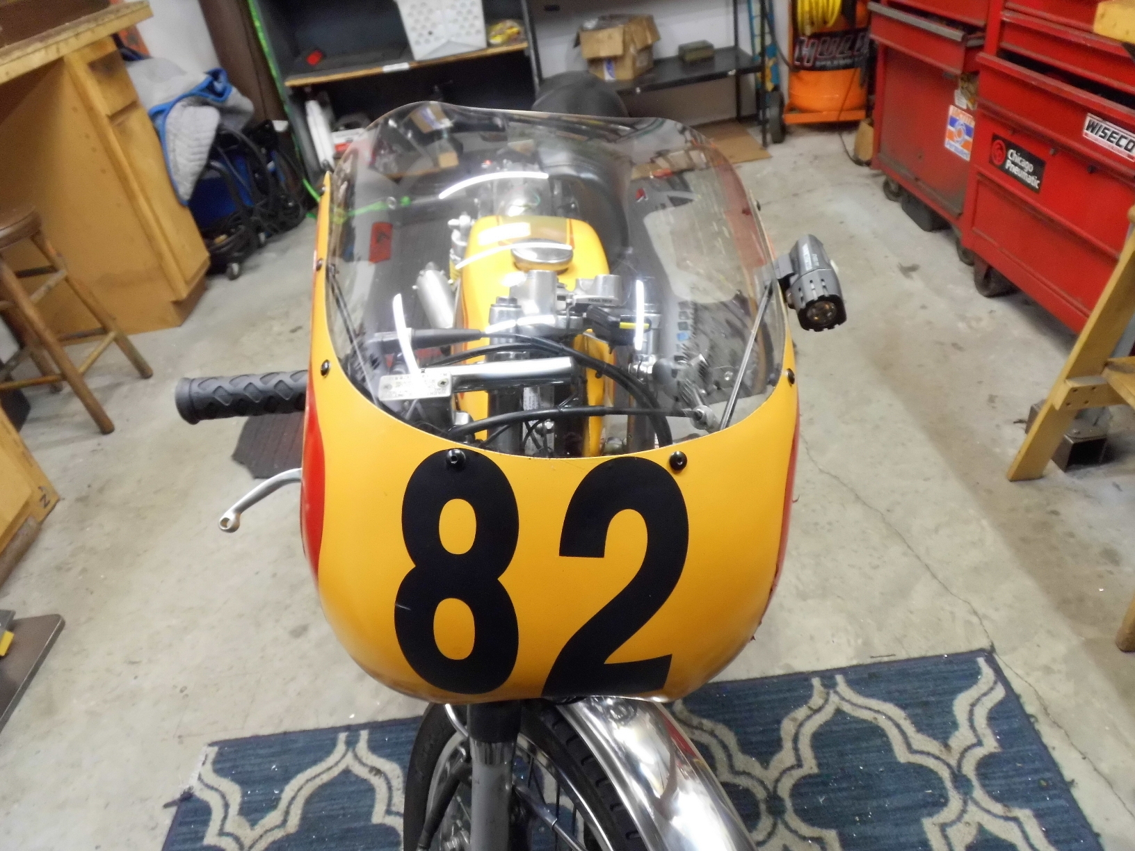

Is that a Honda stocker on the screen?
C
thanks chuck. yup, it is. well was. it started lifting to o peeled it off, but im going to get a wing decal for it somewhere.
