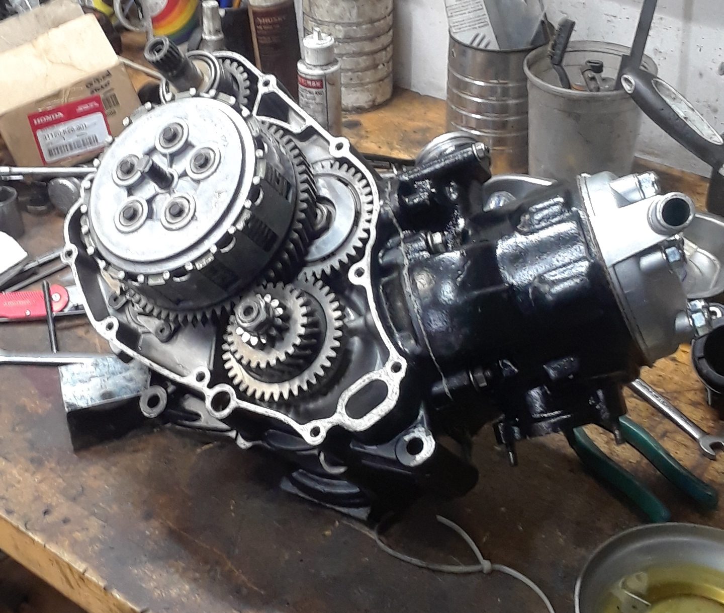

And, it lives. Did a few fire ups but with no cooling system plumbed up, just a short test fire. this was the 2nd one. trans, clutch, and charging system all good.  :metal: :haw:
next up: plumbing and tuning. I have to say, the kicstart situation on this sucks.. it clears but its awkward. I'll figure it out.
http://www.2strokeworld.net/wp-content/uploads/GROM/250-conversion/running-early/grom-2ndrun.wmv

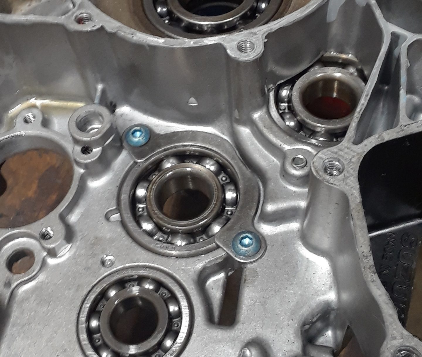

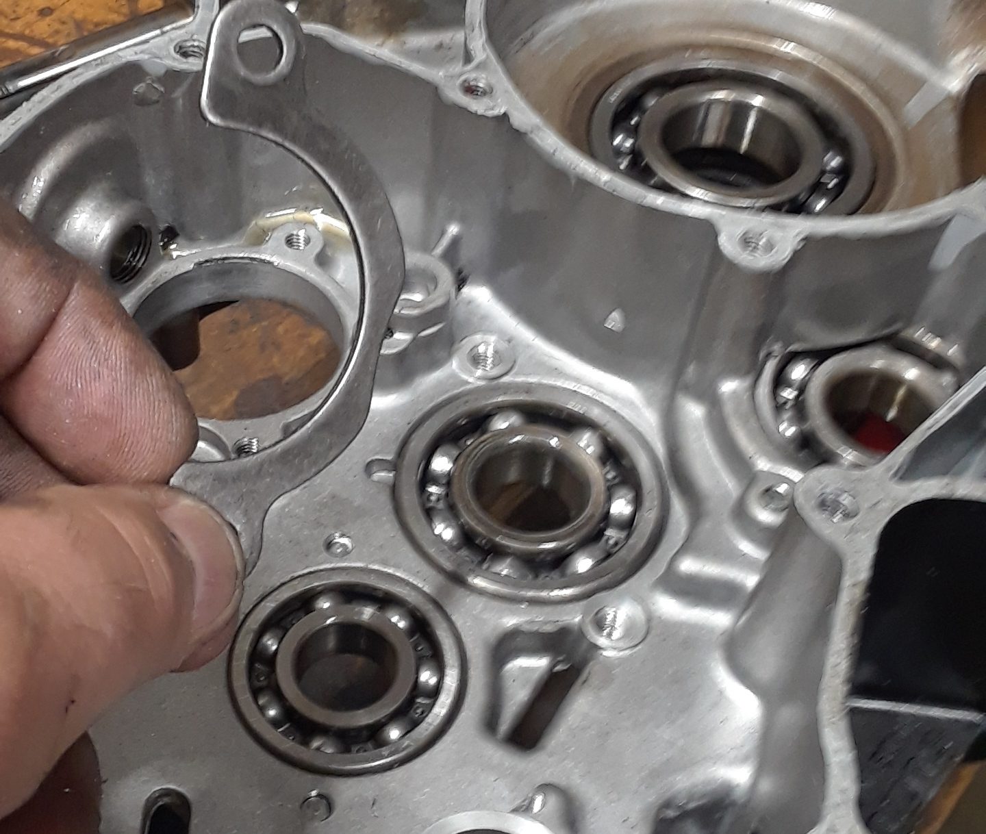

and, this cost me a day. it was one of those 'whats this part in the box?' (after the motor was assembled   :bang:) No, i didnt run it  prior to getting this in. luckily i caught it.

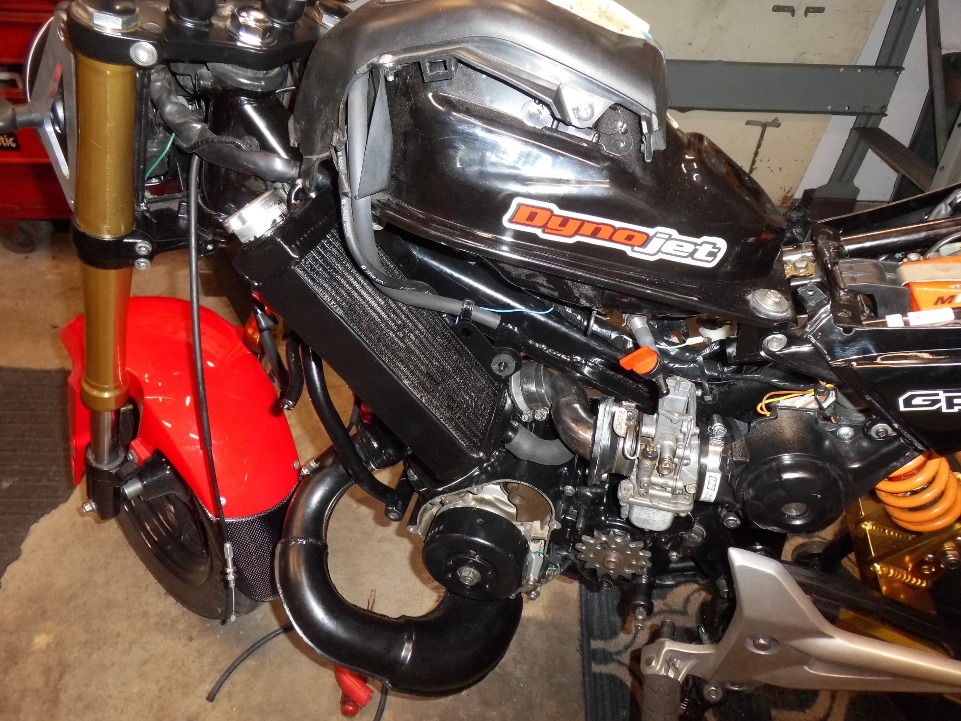

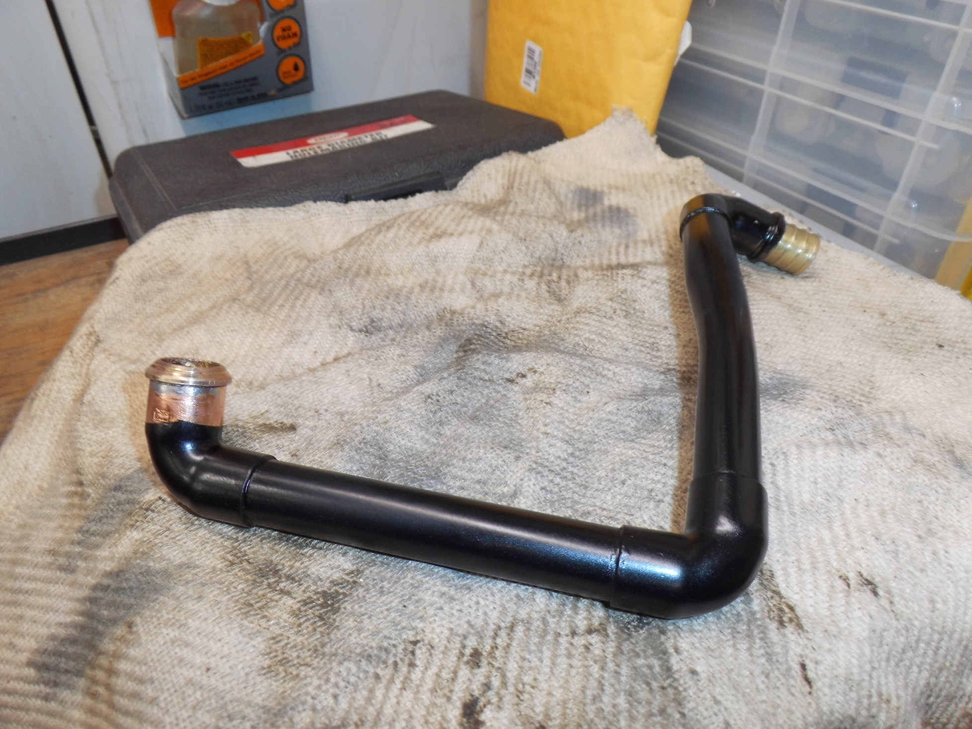

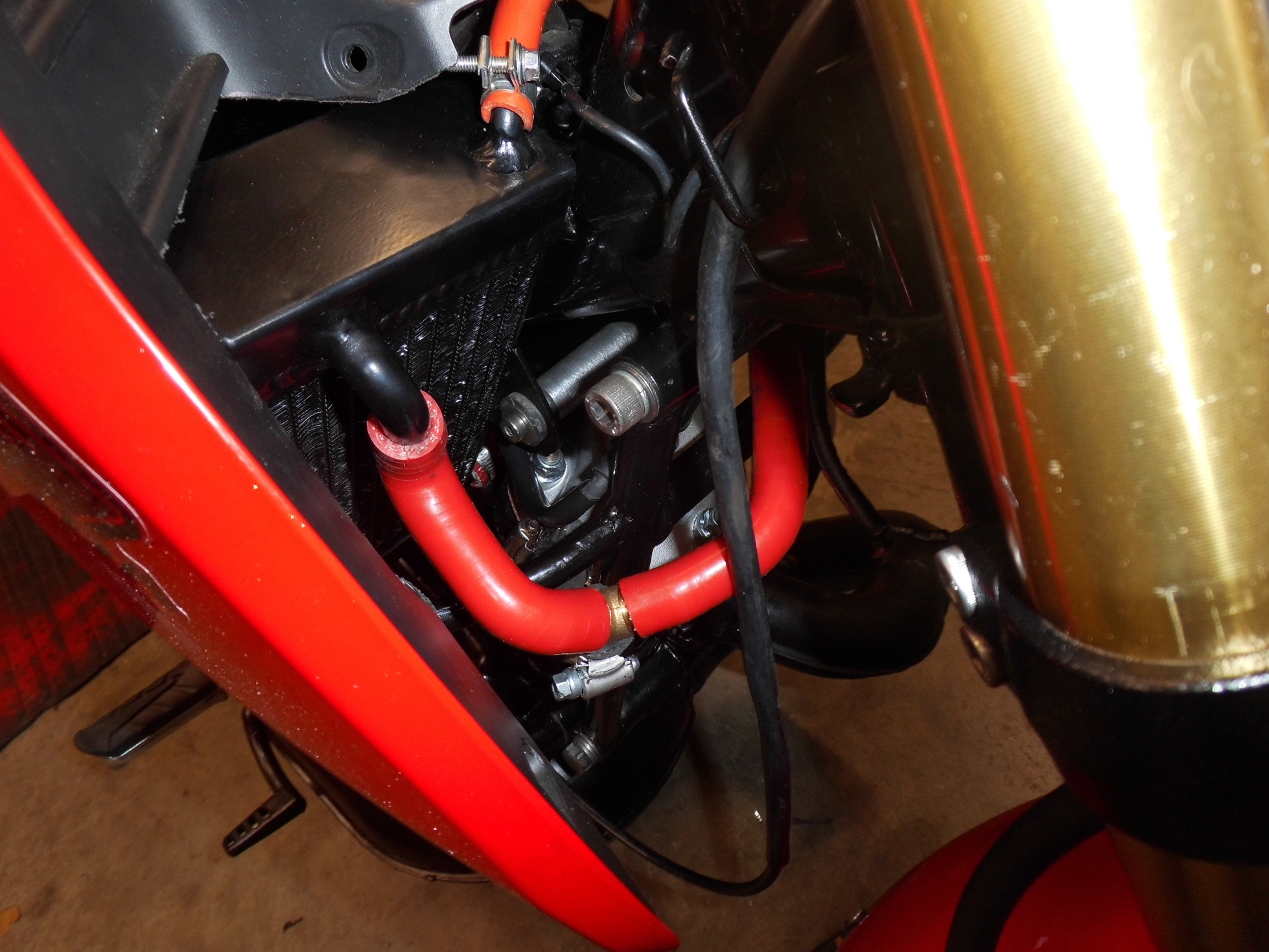

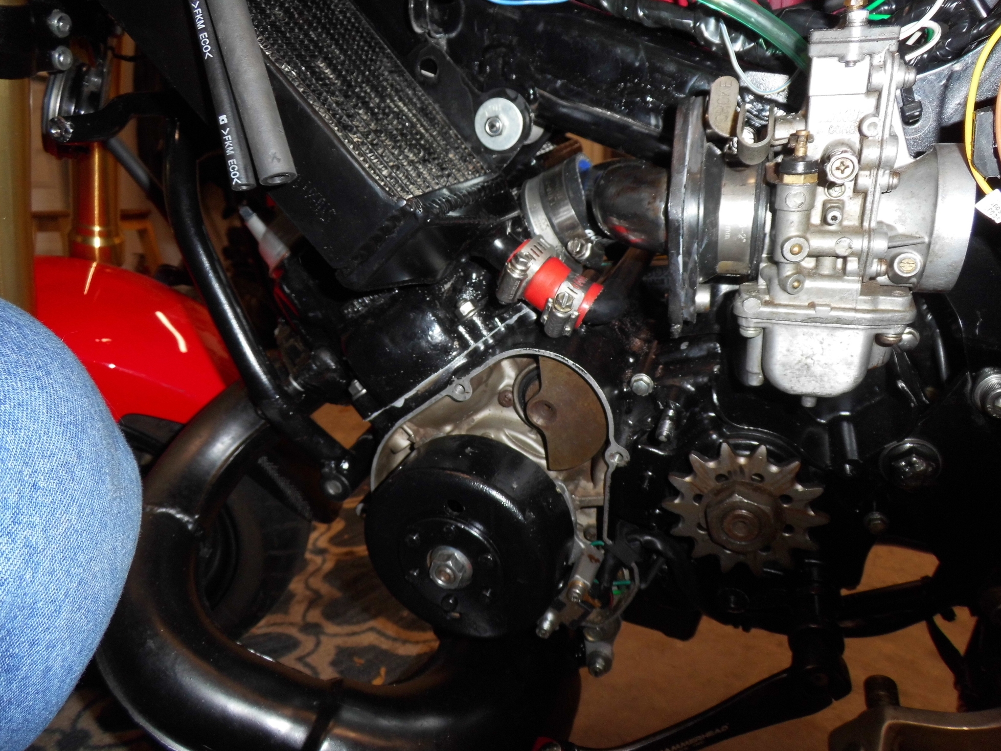

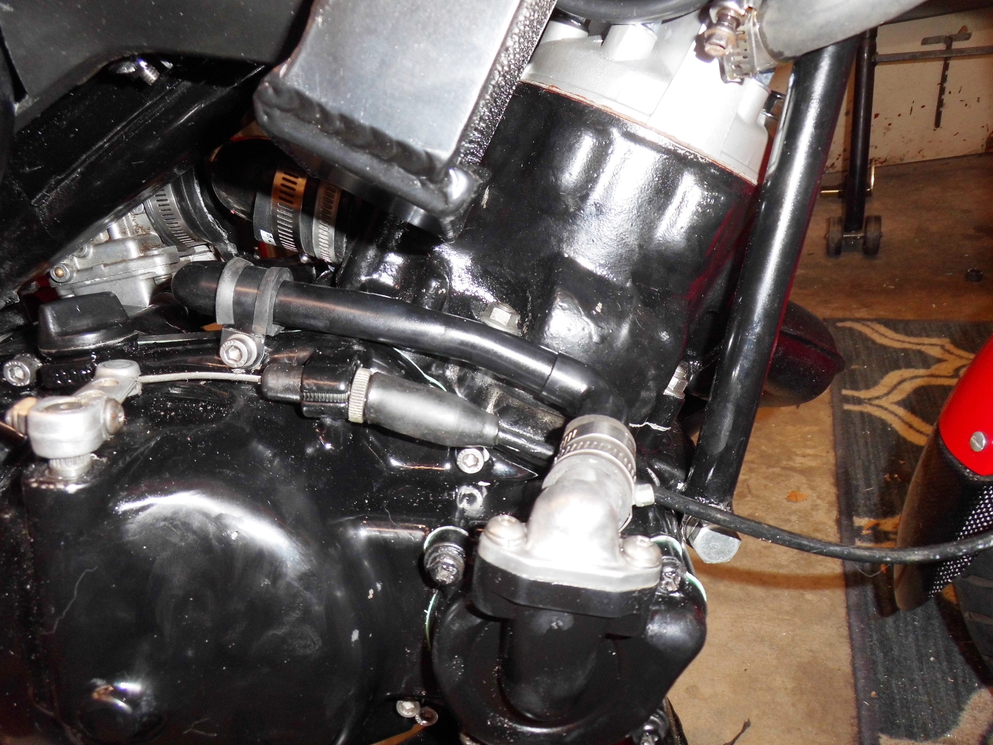

THANKS. It not really a full cradle , front and rear and lower mounts are all independent and hand made. I just got all the plumbing finished last night, had to make a really compact in-line temp sensor fitting which took a while on the lathe, but it should eb good to go. Hopefully tonight i can fill er up with coolant and get started on tuning and hopefully have NO leaks.
heres some pics from over the weekend:
made a hardline from pump to LH radiator.
if that proves to be a problem, i'll order up some stainless tuning and tig weld it together, the tight bends were the challenge mostly.
this is where it terminates on the LH lower radiator
the upper setup, the head outlet is just below the Y fitting. the temp sensor is (now) off to the right of this pic. (more to follow)
I don't have a direct picture, (you can barely see the clamp & hose end in the pic above bottom of the radiator) but hands down the worst part was the lower crossover on the radiators, the clamps were near in possible to get to, have to use a LOOOONG screwdriver to get to them from the back, as it crosses over the intake on the cyl. But, its in there.
