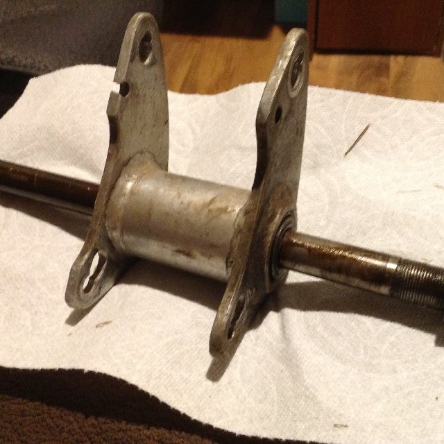

B) sorry to jump back and forth, but here's a better shot of the TZ rear mount, removed from it's natural habitat. It's designed to bolt to both the upper and lower case halves, and since the LC lacks a mounting point on it's lower half, I don't feel this is a good solution for me. Any mechanical engineers out there?

I have never seen a TZ rear mount that looks like that. The TZ only has one set of mounting holes on the back, like a RD. I just checked a TR3, a TZ "B" and a TZ "G", all mount the same as an RD.
The TZ didn't use the top mount either. It was found the vibration would crack the cases around the mount, so after the "B" model there was a service bulletin to scrap that mount. I leave them off RD400 racers with no problems.
An upgrade that WAS/IS done to TZ frames is to rubber mount the motor. The TZ has rubber mounts on the front like a RD400 (a 350 doesn't), but we add rubber mounts to the rear. The frames don't crack nearly as often with this upgrade.

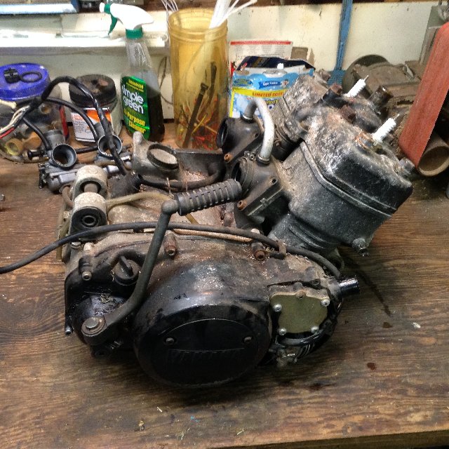

Elsie gave up her engine this evening,without much drama. Oil was dark and nasty, but not glittery, and coolant was clean, clear and bright.
Landed on the bench in the clean room  :bs:pretty little thing she is not.

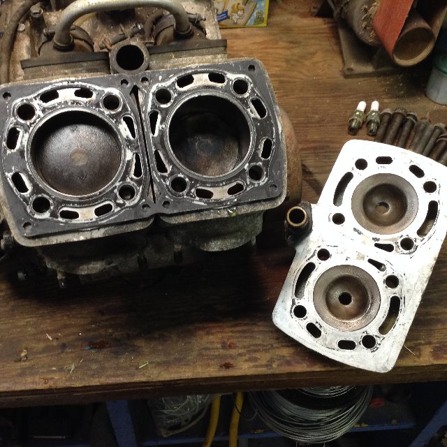

Giant sigh of relief. Couldn't ask for nicer looking crowns or domes. Does the head look uncut?
Someone's been here before me...

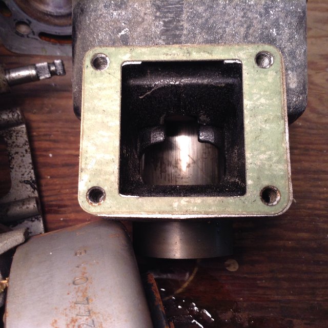

Intakes appear unmolested, but that far cylinder wall isn't happy; yes, I can feel those scratches with a fingernail.
Exhaust port looks unmodified to my untrained eye...what do the LC experts think? Vesrah!
