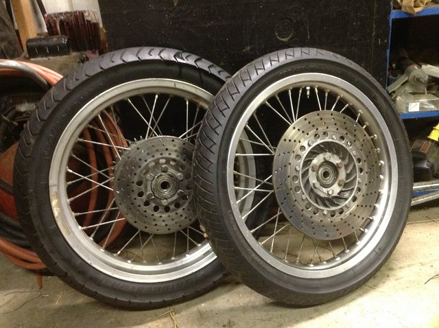

A little progress. Mounted a set of BT45s late of the RZ350 so it'll have some shoes to stand on; they're old and I didn't pay attention to direction of rotation or the balance dots as they're for mock-up only.
I think they look pretty sexy.
toffee
yup looking good, they are a popular tyre choice.
are you going to refit them?
"An object at rest stays at rest and an object in motion stays in motion..." - Newton's 1st law of Motion
Nah, this set is old and hard but they'll do for rim protectors. I think I'm going to try the Continental radials for this machine when it's done.
