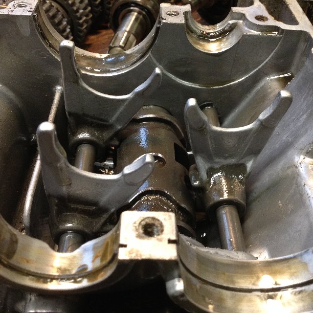

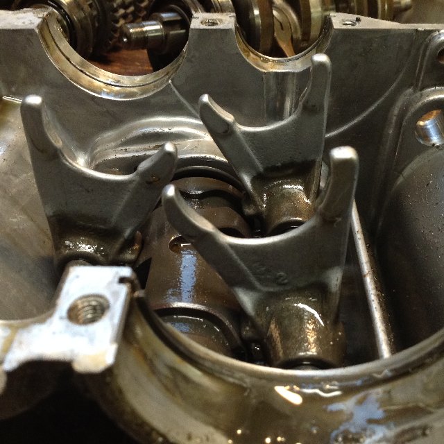

Split the cases this weekend...
No bad news, other than the sludge in the sump.
Really happy to see the forks in good shape! A little more disassembly and it's bath time

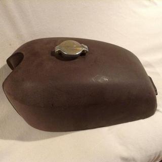

I'm going to need to carry fuel on this machine, and I have this fine SOHC CB750 unit. It seems to sit reasonably well on the frame, but it's kind of, well...BIG. I could look forward to long rides w/o stopping for gas! Thoughts?

Well........if you want a Honda CB750 gas tank on your TZ replica then go for it  :umm:

Re: the tank....let's see it on the frame to scale it.....it all depends on what you're trying to achieve as the end result....a bitsa or replica, like Spoony stated I guess?
That Honda tank looks short and fat.
I think a longer, leaner tank might fit the chassis a bit better?
You're all correct, thank you. I'm all for the bitsa, use-what-you've-got approach, and the 750 tank is on hand...but I don't like it for this project either. I agree with Jim that a longer, TD2-style tank would be more fitting. I also do not want to copy anyone else's ride too closely (Joe, Mark). I'm wary of any old tank, and of the new tanks out of India, having seen the video of the Indian tank cut open. Love the GFTP stuff, but I need to find a more affordable option than new fiberglass.
I'm toying with the idea of making my own seat unit of fiberglass and have a shape in mind, which might influence the shape of the fuel tank I use. I'll keep looking...anybody want to buy a CB750 tank?
Quote from: 85RZwade on April 01, 2020, 01:02:45 AM
Don't worry about copying my bike. There are other tanks that will fit and look decent. Not sure of the year but the XS500 (76-78? I think) had a coffin style tank that looks decent, also the XS360 was similar, maybe even the same tank for all I know. If it were me I would not use that CB tank on anything.

That CB tank belongs on a CB cause it is trying to cover over 4 cylinders instead of 2.
I don't think that tank looks short and fat, it is just big boned.  :eek:
P.S. Good luck trying to copy Spooner's Hybrid. That Picasso is a piece of rolling,wheeling, hauling ass work of art. :vroom:
Yes, please use the TZ/TD etc. style of tank.

 :wave:The people have spoken, I will remove the CB tank immediately (it's just sitting on the RD frame trying to look better). Thanks for the advice, opinions and encouragement, gents. Going to have to spend a day in Portland with Jim...someday, when I can cross the river again.

I found the perfect tank already!
https://www.ebay.com/itm/Yamaha-XS360-XS400-Fuel-Tank-XS-360-400-Gas-Tank/114164455613?hash=item1a94bb58bd:g:7r4AAOSwIlBeg4QY

Good choice. This is my first RD I built when I was in high school. That is an XS500 gas tank.  Built it in 84-85 and sold it in 86 to buy the new FZ600.
